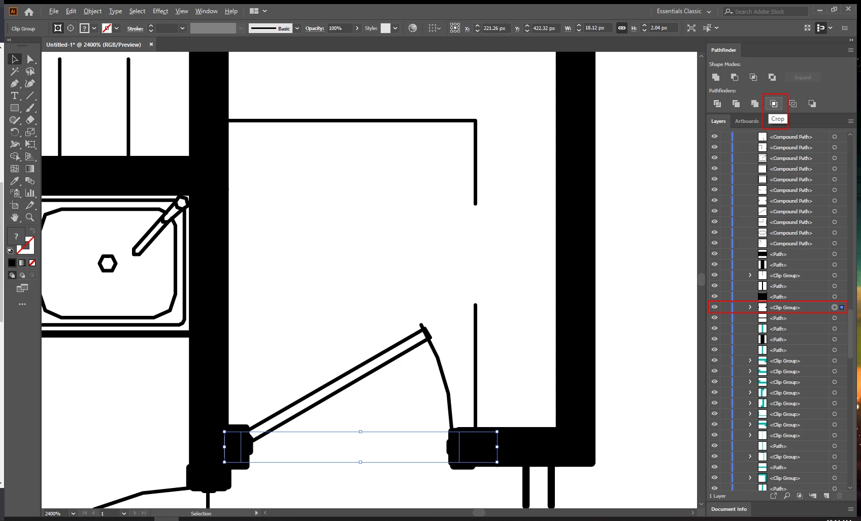

I was wondering if someone had a script, or could help me tweak a script that can target all layers named <clip group> and process them via the 'Crop' Pathfinder tool.
Attached is an ai file with an example floorplan, which is riddled with with these clip groups, as screenshotted:
If I process/remove these clip groups in any other way.. the result is not desired, e.g. this doorway clip group would collapse and appear as a solid wall basically:
I set these floorplans to be interactive on a website, and unfortunately if I don't process these clip groups before uploading it to the web, they all appear like this doorway>wall.
I did spot this script on the web, but unfortunately it processes the clip groups to the undesired result screenshotted above ^ I'm not sure how to tweak it so it processes clip groups via the Pathfinder crop tool.

Correct answer m1b
Hi @Steve23534591lq4l, I made some adjustments to your script:
clipScan(app.activeDocument);
function clipScan(doc) {
    // loops through all groupItems, removing those that are clipping masks
    var clippingCount = 0;
    for (i = doc.groupItems.length - 1; i >= 0; i--) {
        if (doc.groupItems[i].clipped == true) {
            doc.selection = [doc.groupItems[i]];
            app.executeMenuCommand('Live Pathfinder Crop');
            app.executeMenuCommand('expandStyle');
            clippingCount++;
    doc.selection = null;
    alert("All " + clippingCount + " clipping masks expanded.")
You were targetting the wrong page items I think. I targetted groupItems that are "clipped" rather than pageItems that are "clipping".
            clippingCount++;
- Mark
March 11, 2022
Ah thanks Mark, that's perfect 🙂 Appreciate the help mate!
