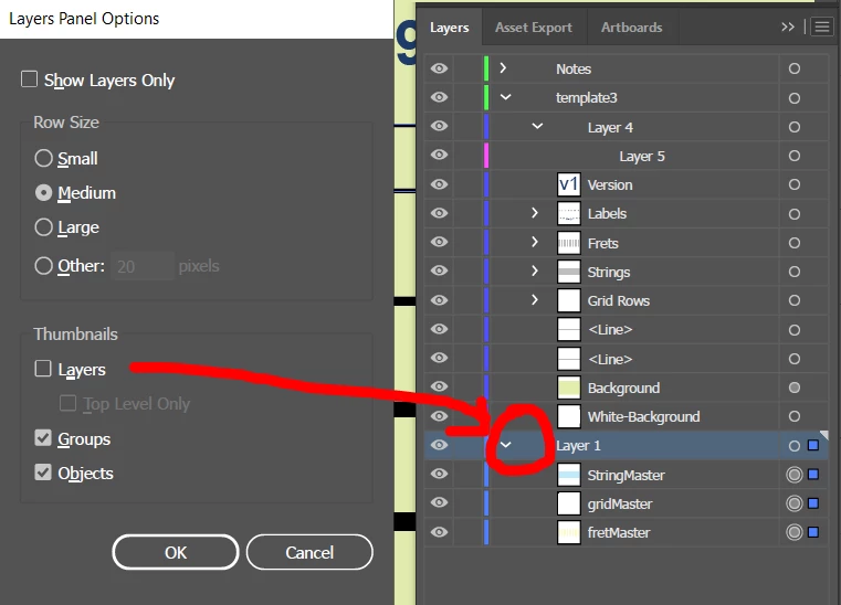

CarlosCanto
May 8, 2020
william, also if you need this a lot, you can turn Layer Thumbnails off to quickly tell what's what.
