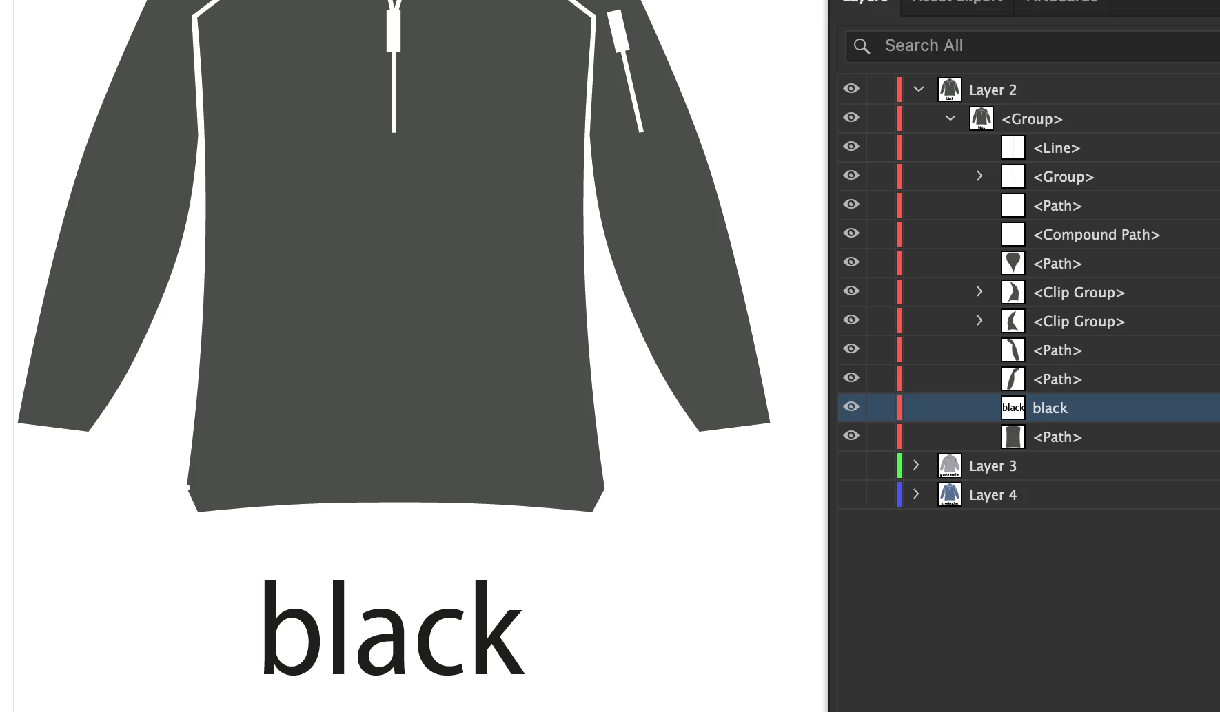

I'm looking for a scipt that will change the layer name to the same as the text contained on the layer.
So in this instance it would change Layer 2 into black.
Is this possible?

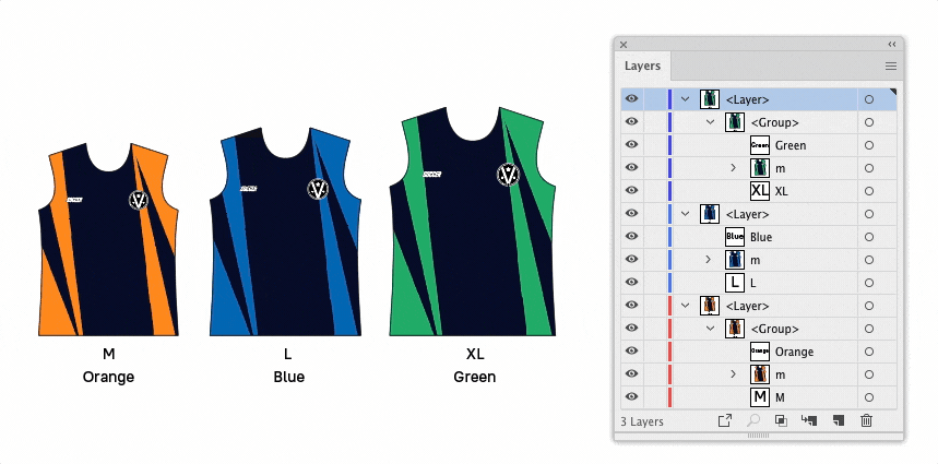

I will add my own version. The interface allows you to manage the renaming in a flexible way. The script first collects all text objects in the layer and then takes the first or the last one for the layer name.
https://github.com/creold/illustrator-scripts/blob/master/md/Layer.md#renamelayerastext
