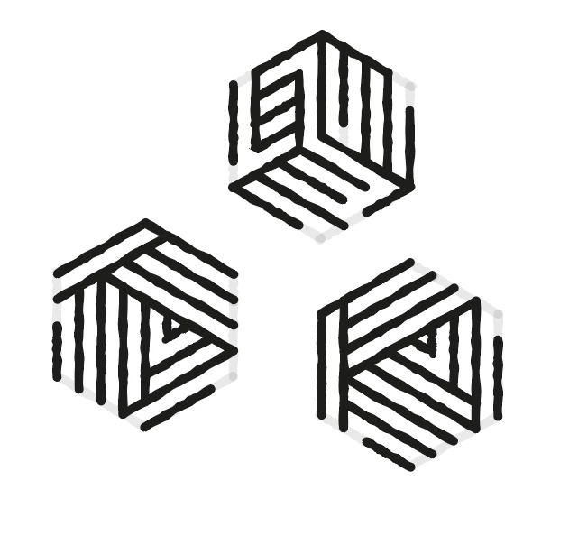

I like the pattern! Clever choice of hexagonal cells I think. Would you mind posting a screen shot of the 3 hexes you used?

runninghead_design
November 2, 2020
Interesting! I'll look in to this ASAP and amend the script (almost midnight here). Thank you @m1b !
As I hope is visible in the screen grab, I used 0% transparency on some line segments to preserve the overall hexagonal shape for the 3 symbols (restored these to 10% for the grab).
Roughness provided by a custom line profile.
Many Escher tesselations seem to break down to 6 triangles within each hex, triangles that link back in to each other. This affords a powerful method for interlinking of decorative or illustrative artwork. I'll attempt some more patterns soon and post here.
