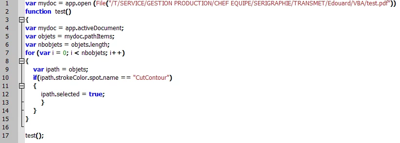

Hello, i'm new in scripting. I want my script to select paths based on the spot color named "CutContour"
I copied it on similar scripts i found in this community, but it doesn't work.
here's the script :
I keep getting this error "undefined is not an object" on line 10 and can't find any solution.
Can somebody help me, please ?

femkeblanco
June 15, 2022
Change line 9 to
var ipath = objects[i];
Edouard76Author
June 15, 2022
thanks for the reply. It works but there's another path in a 2nd layer also named "CutContour" that hasn't been selected in my test file.
and i still get the error after
All files (7000 !) I have to upgrade are made like this one.
