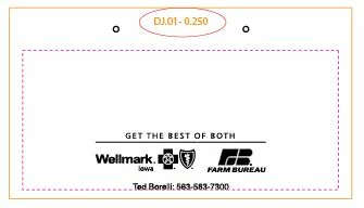

     I'm new with scripting and haven't had a lot to do with it, so i'm looking for a little help. I need to add to my companies existing Script Pallet, we have a script that creates our art into dies for us. So that they can be used for Debossing/Hotstamping items. But, we need the "Die" to have the Name of the job on it, so i'm trying to get a box to prompt up to add that text to the top of my die...I have got the box to come up but i can't get it to put the text on the art. Am I missing a link somewhere?
