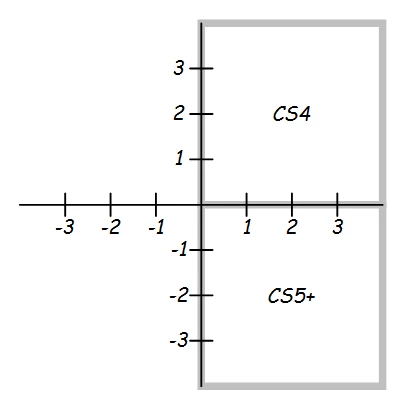

change the last number to be negative. My brain isn't remembering the reasons why, and I dont want to give you wrong information, but if you change the 200 in your rectangle coordinates to be -200 it should work.
app.activeDocument.artboards[0].artboardRect = [0, 0, 300, -200];
femkeblanco
January 29, 2024
Back in CS5, the origin was changed from the left bottom to the left top.  So y values should be negative, as in the examples above.
