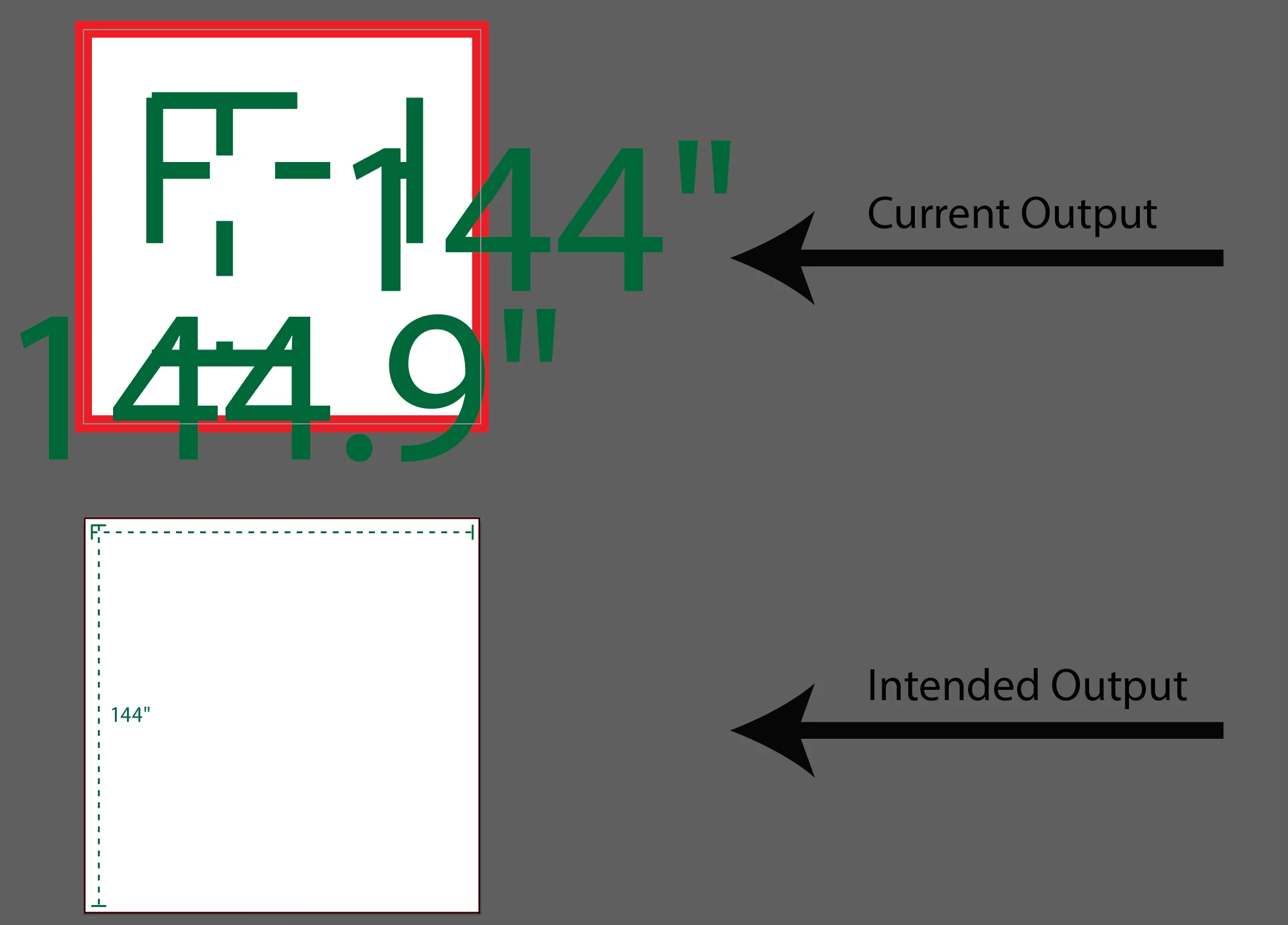

Hey Mark @m1b! Thanks so much for looking into this! This solves one of the issues the script is having for sure! The problem your changes solve is to the printed output! For example, instead of 8.43" printing it prints the intended 84.3" so the value is correct, however I still am having an issue with the scale when it comes to generating things! I've attached screenshots to further explain!
Again, my previous code works on standard canvas size, but on the Large Scale canvas size the things that are generated are 10x to large. Hope that makes sense!

Hi @Mikey_Englar1374, sorry I should have thought to point out how Large Scale Documents work in the scripting context:
1. Documents have a 'scaleFactor' property which is 1 for a normal doc, and 10 for a large scale doc.
2. Nothing else! That scaleFactor property is the only difference between the two types of documents.
So from the point of view of a script, your large scale document is actually 1/10 of the size the UI says it is, and your script must take it into account. So if you want to make something 10" wide on a large scale document, you make is 1" wide. Try it!
Basically it means that our scripts must constantly factor in the scaleFactor whenever sizing things (or reporting on size, as I changed above). For example here is a function that draws a rectangle, you can see how I incorporated both scaleFactor and "unitFactor" (there are 72 points in 1 inch).

HOWEVER, I made a bad mistake when I adjusted your scripts earlier. I forgot you wanted the print outs in inches, so we must adjust for that. Also I had an incorrect divide by 10 in there—no idea why! Could you change those calculations to these please:
var textWidth = (Math.round((objWidth / inch) * sf * 1000) / 1000) + '"';
var textHeight = (Math.round((objHeight / inch) * sf * 1000) / 1000) + '"';
and
var textWidth = (Math.round((abWidth / inch) * sf * 1000) / 1000) + '"';
var textHeight = (Math.round((abHeight / inch) * sf * 1000) / 1000) + '"';
and, at the start of your script define a variable (or constant):
const inch = 72;
And I hope everything will be back on track. Sorry I messed that up.
