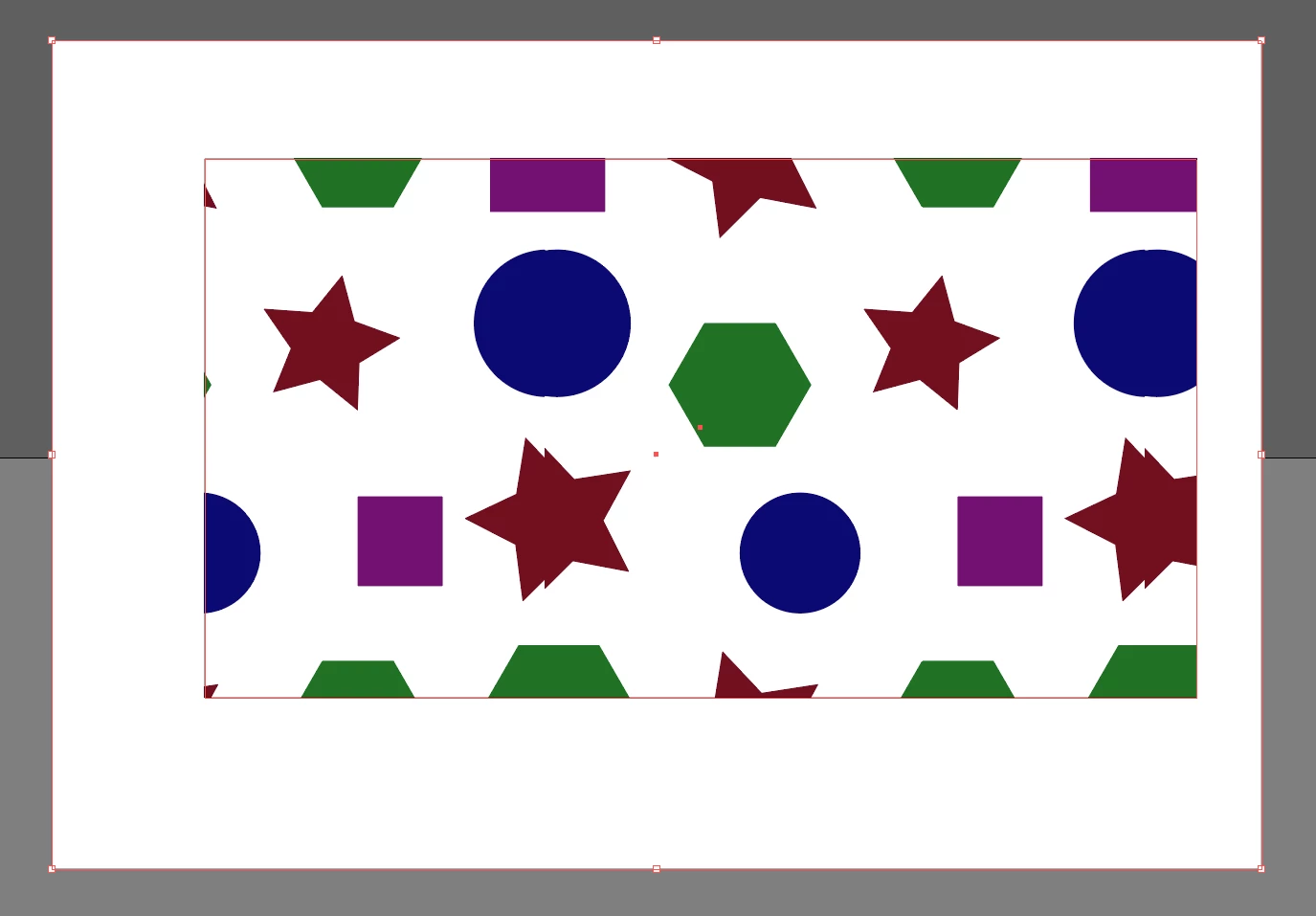

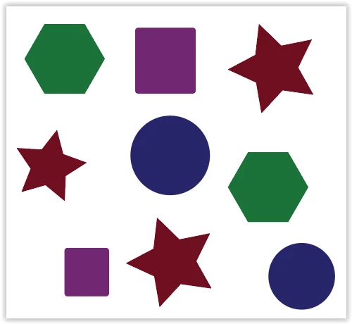

For some reason my seemless pattern has objects that are doubling up. I cant figure out why it is doing this. If anyone knows why this is happening please help me out. Thanks a bunch in advance.

Rene Andritsch
February 11, 2023
It seems as in your pattern there are two stars on the same spot / or on the left and right edge which will result in them showing up on the same spot. As they are a different size there might be two stars you are dealing with.

Step111Author
February 20, 2023
Finally got around to trying this method and it worked for me. Thanks a lot!
Ton Frederiks
February 11, 2023
How do you create them, do you use the Pattern maker?
Step111Author
February 11, 2023
No I don't use he pattern maker because from my understanding you can't use it as a swatch if you do it that way. I place my objects On the left and duplicate them to the right. Same for top and bottom. Then I fill the middle and create a bounding box. Last I crop it to delete the parts of the objects that are hanging outside the lines. Drag it to my swatch panel afterwards. I then create a square and fill it with my design. If I scale to the exact size of my art board I have no problem. But if I scale larger I get the issue posted.
