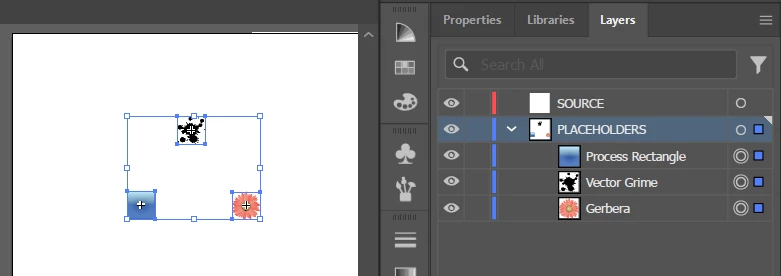

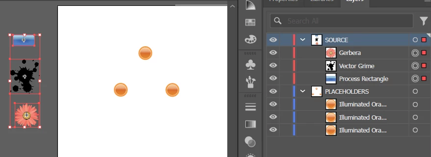

here's a basic test case script that will replace placeholder items in Layer 1, with source items in Layer 0 (top layer)
set up you test file like this
the script will match each Layer 1 placeholder item's size and position to each Layer 0 source item, then it will remove the placeholder item
result
result
