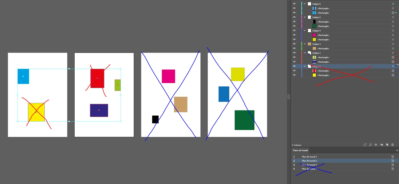

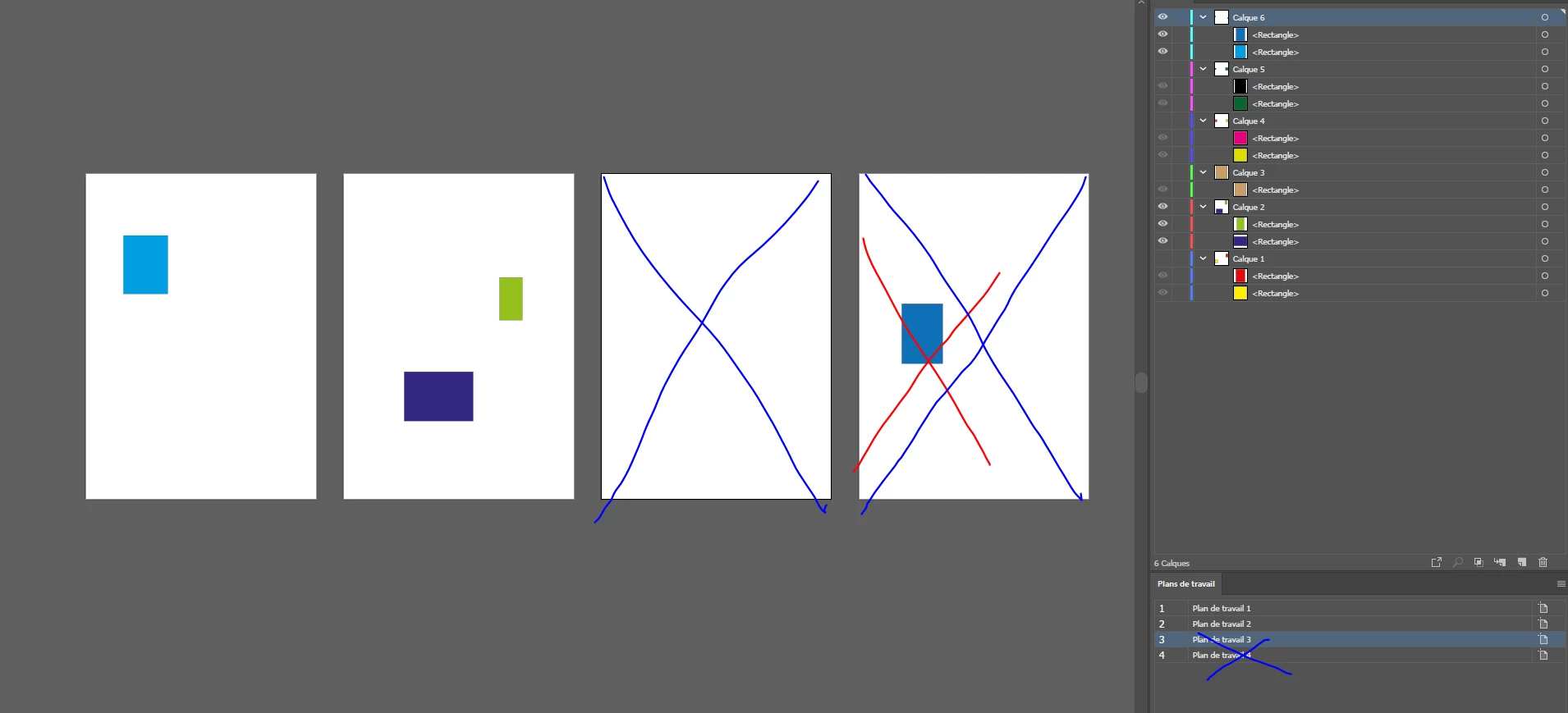

CarlosCanto
July 3, 2018
Hi Miyano, there may not be a single command to do what you need but it's likely there are workarounds. Please provide more details preferably with screen shots or better yet a sample file.
Miyano_
Miyano_Author
July 3, 2018
Hi Carlos !
In this example, I want to export artboard 1 and artboard 2 into a DXF file. But I only want the objects in the layers 2 and 6 (not the objects of layer 1).
I have made a program that makes all layers invisible and after that makes wanted layers visible. I also made a program that pinpoints the artboards that I would like to export in the area thanks to their names.
[ I can share the program I made if you want but it is long and tedious   ]
The problem is that I am unable to combine both programs thus I am unable to select specific objects (that are on specific layers) of wanted artboards
Dont hesitate to tell me if you do not understand,
Thank you very much for your answer!!!
Miyano
