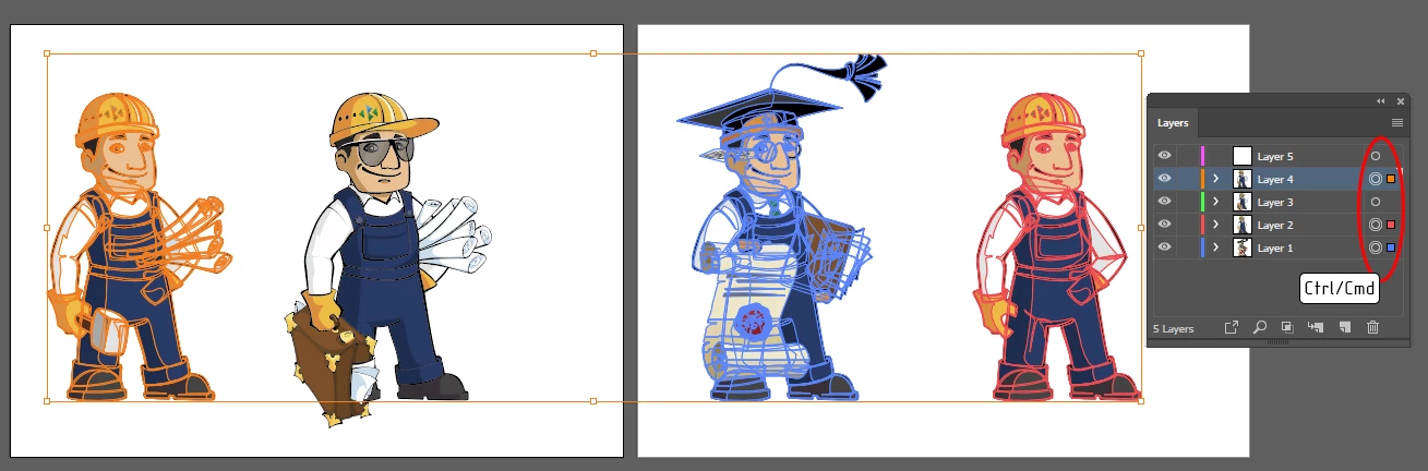

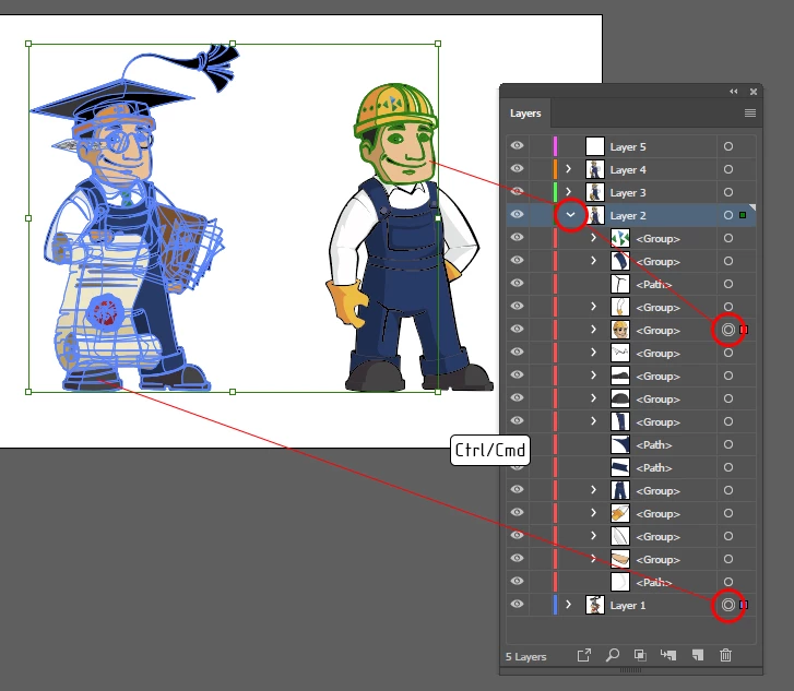

    Look: you click on the circle at the right using Ctrl/Cmd and get the multiple layers selected.
    If you need to select some separate objects on different layers, you should expand the layer stack (the arrow at the left) and click on the circle at the right of needed object

    No. You don't select the layers by clicking on the circle. You also don't select the objects. You target them, which is something different.

    yes, you are right, I should be more accurate in terms. Generally, I use effects very rarely, so in my work, it does not make difference.

    By selecting the layers with the circle on the right with with shift or cmd to select multi layers , you select all unlocked objects on them!
    you can copy (cmd c) and past (cmd v) on new layer.

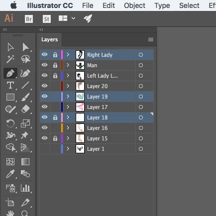

    Ton Frederiks
    December 4, 2017
    You can select layers by shift clicking on the layer names, layers between the first click and the second shift click are selected..
    You can then move these layers and their contents above or below other layers.
