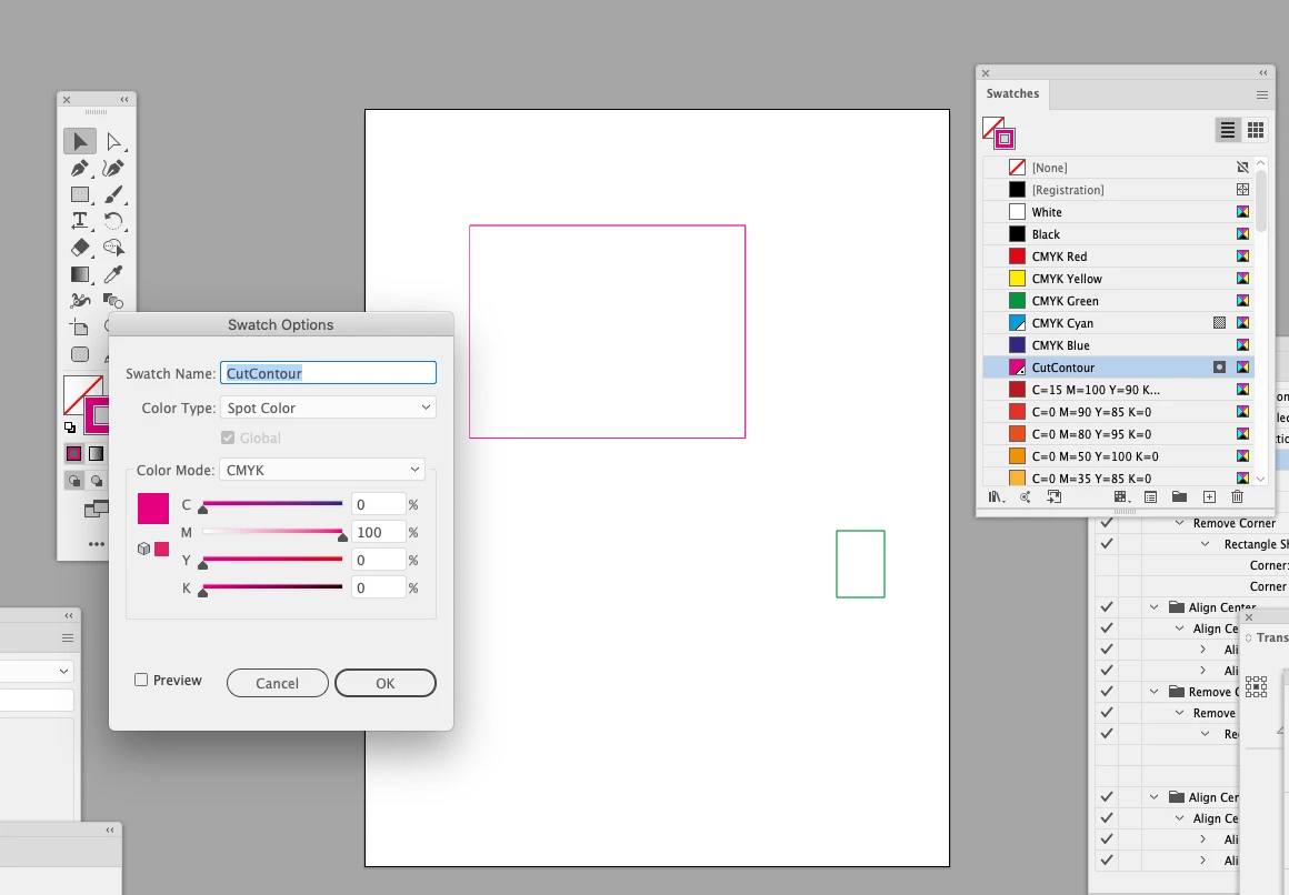

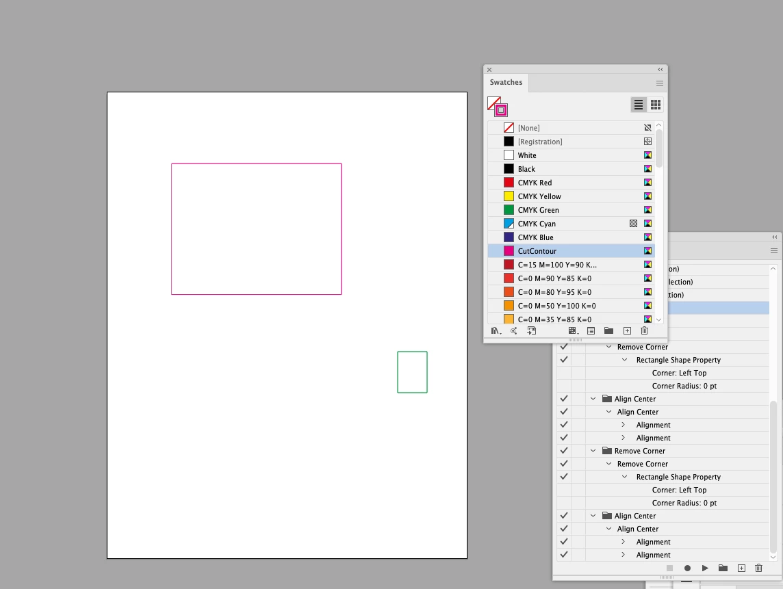

Hi I have rectangles in all kinds of colors and other objects
I want to select only rectangles / shapes whose color contour line is Cutcontour. (Spot color)

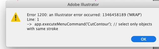

You can use following commands to select
app.executeMenuCommand('Find Stroke Color menu item'); // select only objects with same stroke
app.executeMenuCommand('Find Fill Color menu item') // select only objects with same fill
app.executeMenuCommand('Find Fill & Stroke menu item') // select only objects with same stroke and same fill
Before executing these command, make sure to select the spot swatch in swatch panel.

there is a problem

You can't use 'CutContour', you need to have

Could you please post screenshots with the pertinent Panels (Toolbar, Layers, Channels, Options Bar, …) visible?
Shape Layers cannot have Spot Colors so far, so I am not quite sure how exactly your file is set up at current.
