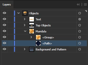

Sorry to all of you but I ain't understanding a single thing you guys are saying.
Let me be clear again. All I want to do is
Scenario: 1
There is a layer named 'Object'
It has a group named 'Background'
The 'Background' Group has a subgroup named 'Mandala'
Scenario: 2
The 'Mandala' group has a file named '<Path>'
the <Path> file is just a normal layer
In my post, I showed a script that can select the 'Background' group but not the 'Mandala' group or the '<Path>' file.
Why do I want to select the Mandala Group or the '<Path>' file?
Because Illustrator action doesn't record the selection of a group and that's why I want to select that 'Mandala' group or the '<Path>' file and put it on the action.
That's all I wanted to do. Now plz give me a fully perfect script for that. I really appreciate it.
Thanks and sorry for the circumstances.

<Path> is the name of that file. I want to select that file.
femkeblanco
June 3, 2020
At present, <Path> (between angle brackets) is nameless. If you want to reference a path by name, you will have to name it. Once you name it (for example, Path, without angle brackets), you can select it as
app.activeDocument.layers["Objects"].groupItems["Mandala"].pathItems["Path"].selected = true;
RahativeAuthor
June 3, 2020
It's not working 😞

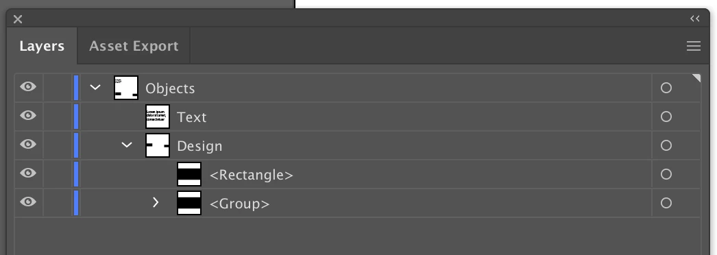

June 2, 2020
If your design looks like attached screen shot and assuming there is only single path inside the main group "Design", then following snippet will work to select the path
var docRef = app.activeDocument;
var layers = docRef.layers;
var layerName = "Objects";
docRef.selection = null;  //ensure there is nothing in the document selected already. this way you only get the selection you want.
try {
    var myLayer = layers.getByName(layerName); //this defines the layer that you want to get the selection from
    for (var a = 0; a < docRef.groupItems.length; a++) {
        if (docRef.groupItems[a].name == "Design") {
            var pathItems = docRef.groupItems[a].pathItems;
            if(pathItems.length ==  1){
                pathItems[0].selected = true;
} catch (e) {
    alert("Layer with name - " + layerName + " doesn't exists");
If you have different work flow scenario, please let us know
