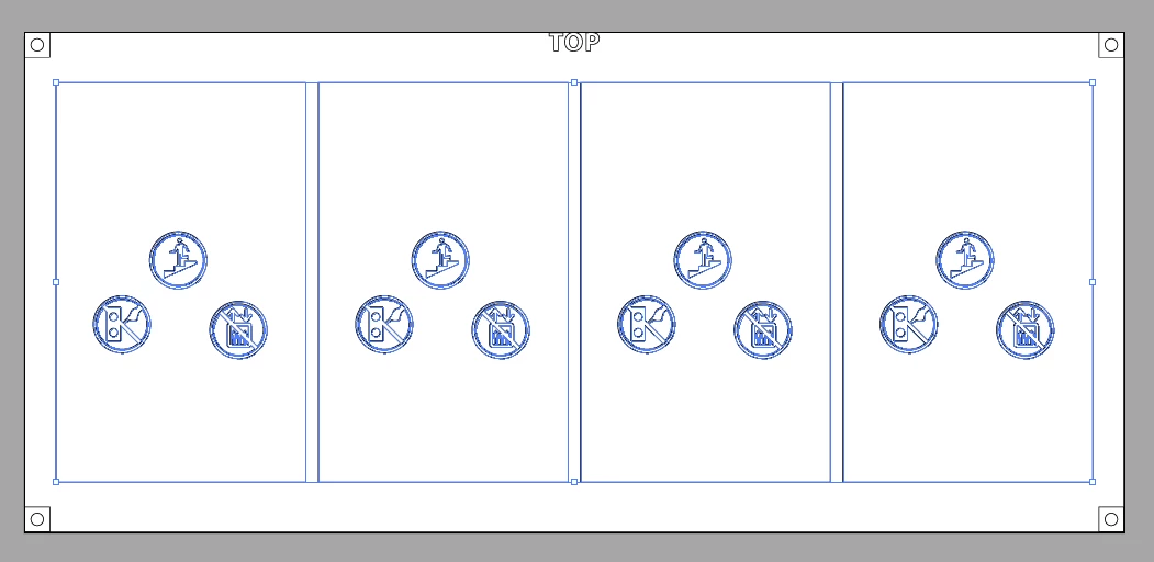

Is there a way with a script to select all objects on an artboard, fit the artboard to those objects, then exclude from that selection any objects that are within a specified distance from the new perimeter of the artboard? Or really anything that gets me closer to this as an end result?
For instance, I have a number of paths/objects in the center of my artboard that I would like to select but have registration marks and notes within a 1/2" from the edge of the artboard, could I select these interior objects and leave out the registration marks with a script?
I have found a few scripts that can search and select by element size/appearance but not any that select based on artboard boundaries. Not sure if this is even possible.
Thank you!

It's certainly possible to do what you're asking for, but extremely unlikely you'll find a readymade script to do so. Do you have any code put together so far that you'd like to ask questions about or get some guidance? Or would you like to have someone write it for you?
February 7, 2019
My first hope was to see if it was possible to even perform the action, so thank you! My second hope was to see if anyone knew of any script or snippet that was already available so I didn't need to start from scratch even if it wasn't exactly performing any of the sequences of functions I was describing.
I don't have anything yet but am going to attempt to cobble something together using some existing scripts now knowing that it is at least possible. I'm newer to the scripting side of illustrator so I'm just experimenting with other user's scripts at the moment.
