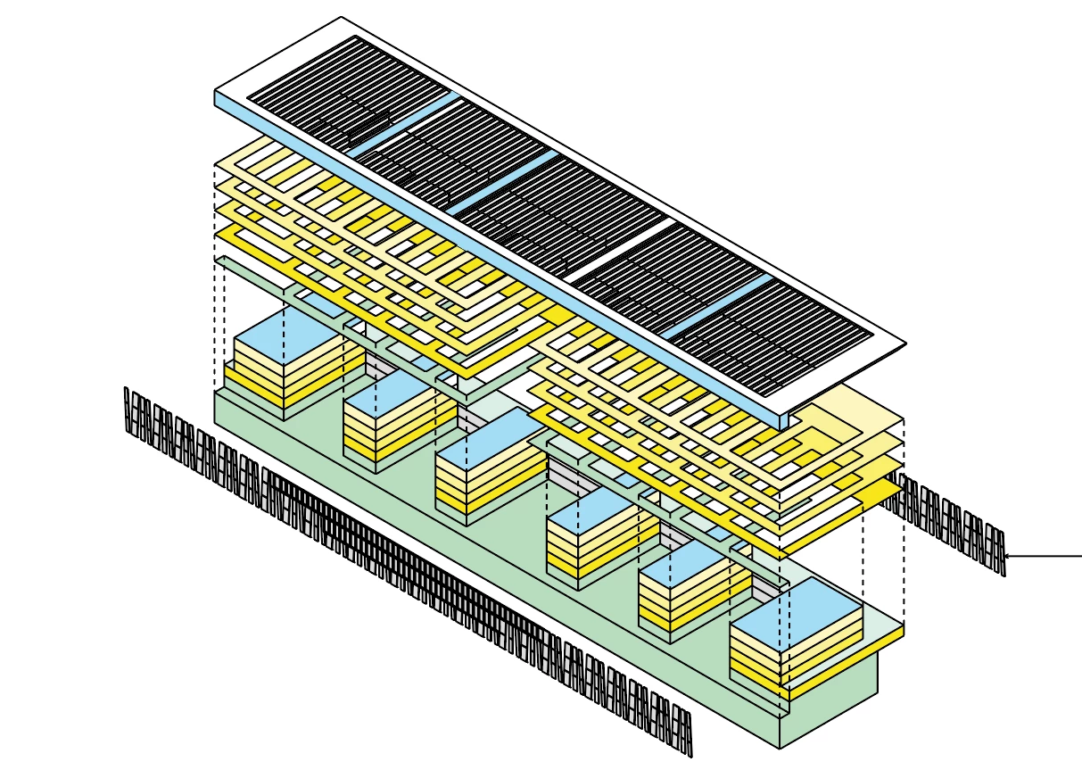

    What I tried to do (it was quite quick):
    1. As the lines are in 2 appearances, solid and dashed, I used Select > Same > Appearance command and grouped the selected objects. This way I isolated the lines from all other parts of artwork. You can also temporarily turn Off the group's visibility to see better other objects.
    2. Without the contours, it's easy to select the needed filled objects. Now it was enough to just click on the top light-blue elements with Shift keeping. In other cases you can use lasso or Select > Same > /the needed property/ command. So I moved the selected objects to the new layer ("Silhouette").
    3. Activate Isolated mode for contours (double-click on any line in the group).
    4. This step is not so nise because all parts of the outline are divided by intersection points. It's no way to select them together and not catch others with the same properties. So I suggest to start from the outer part which must be moved to Silhouette layer. Select them (I clicked at the each dash with Shift), cut and paste-in-place on the needed layer.
    5. This will create an empty area around the inner elements and you can select them by lasso easily.
    the result: https://drive.google.com/open?id=1hEg7zwMGWZxyZCkBQNrzX7MOG2TAL-rS
    I hope this workaround can help to do the job a bit faster 🙂

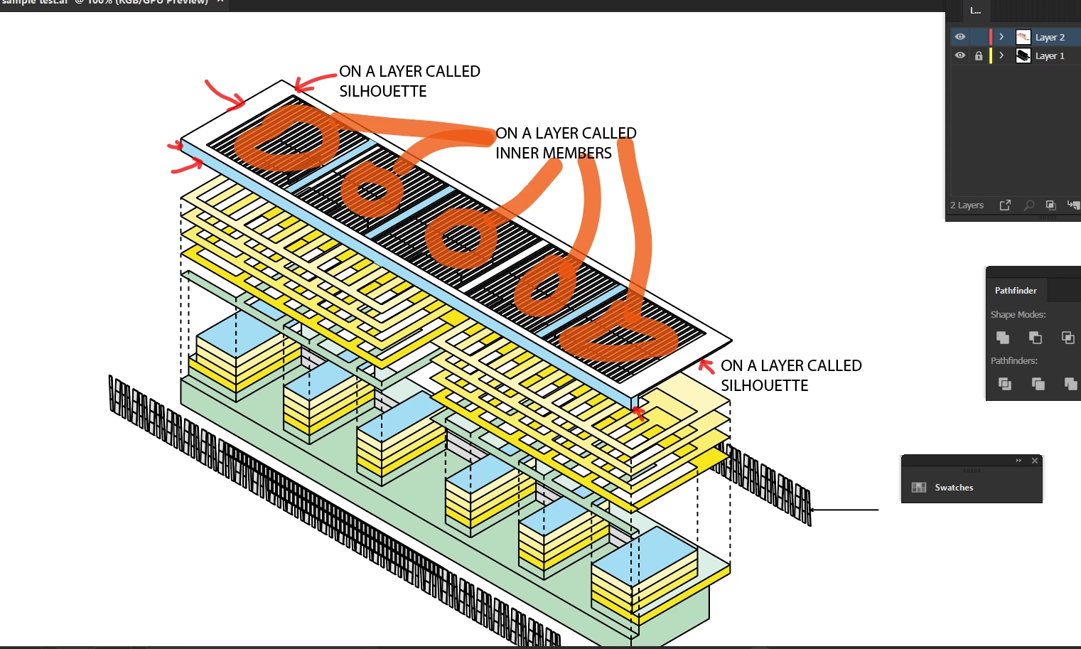

    Here's what my file looks like.
    Here's how I want to organize it a little.
    The inner members of the pergola at the top should go on a separate layer. Its outer profile lines should go on a separate layer.
    Currently selecting with lassso, then deselecting elements, click by click, then dropping them in layers, then removing unwanted elements in layers is what I'm doing.

    I think you might be more successful if you try and tug away the other elements first: everything that has yellow fills, etc. Put it on its own layer, then see what's left.
    You could also try out the new "Global Edit" function. Maybe you can apply a neon green stroke to them and then better select them all?
