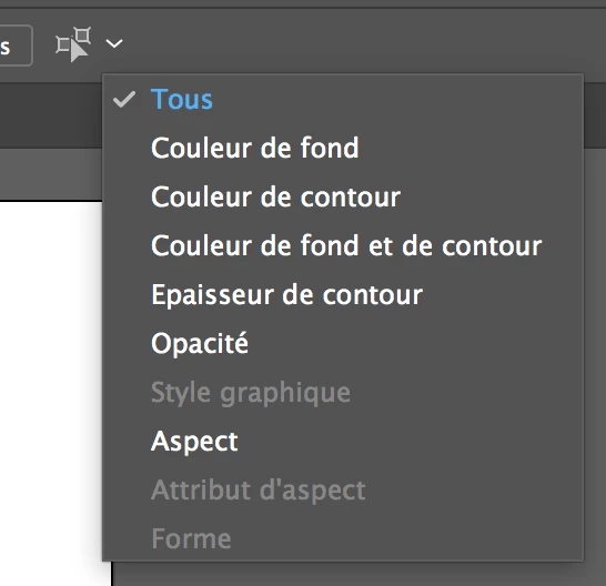

Franck Payen
November 8, 2019
Also, following my colleague's answer, you could easily catch objects of the same color with the "select same…" button on your main control bar or the selection menu.
