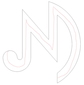

Shape to Stroke
Black color outline is a shpe. Is there any tool to convert it into stroke which can run through the middle [red line indicates]? I can try it in a usual way but it is a long way.

Maha,
You can work on a copy on top of the locked original as follows:
1) Hide the original;
2) Cut the copy at the spot where you wish the new stroke to end at the lower left (the J part);
3) Deselect, then with the Direct Selection Tool Click the end segment at the bottom of the D part;
Now you have two open paths to work with;
3) Click one of the end Anchor Points at the bottom of the D with the Pen Tool, then press P, then Click the other end Anchor Point, and switch to the (normal) Selection Tool;
4) Object>Blend>Blend Options, set the Spacing to Specified Steps: 1 and set the Orientation to Align to Path;
5) Select the open paths from 3) and Object>Blend>Make;
6) Object>Blend>Expand;
This ought to give you a stroke that works most of the way;
6) Adjust the end bit of the new stroke at the J part where it departs from a clean soft bend, using as few Anchor Points as possible, working with positions and Handle lengths/directions.
You can give it a try and show your progress/issues, still using the Insert Photos button which appears directly in your post.

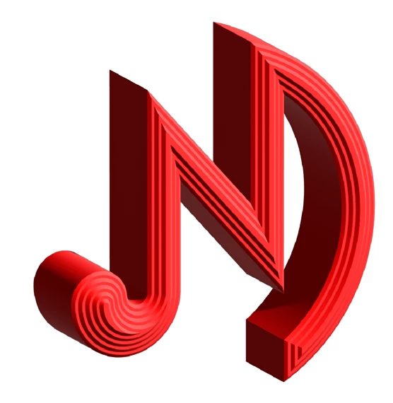

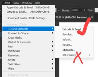

Thanks for the replay. I got a better design than intended one with Extrude & Bevel tool. My 3D (Classic) did not work with the file. That was the reason I sought above method.
