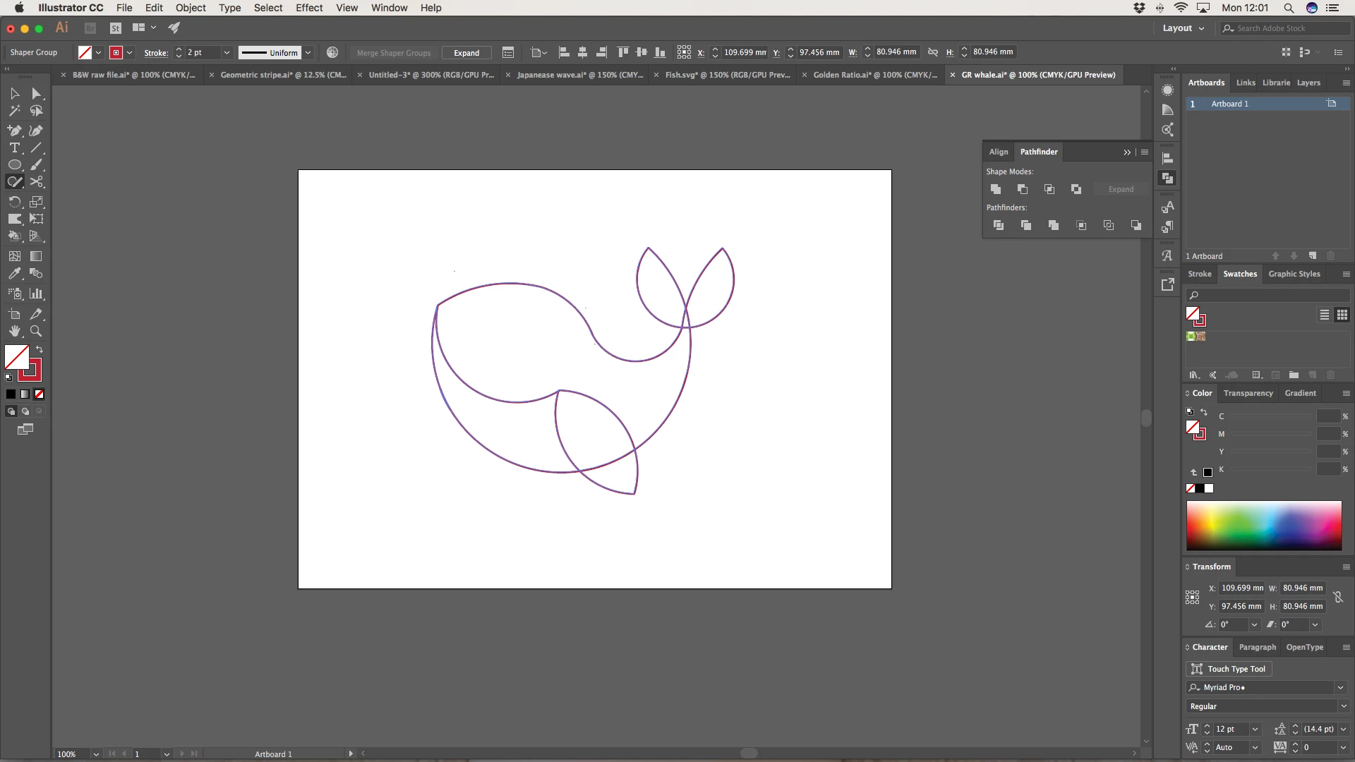

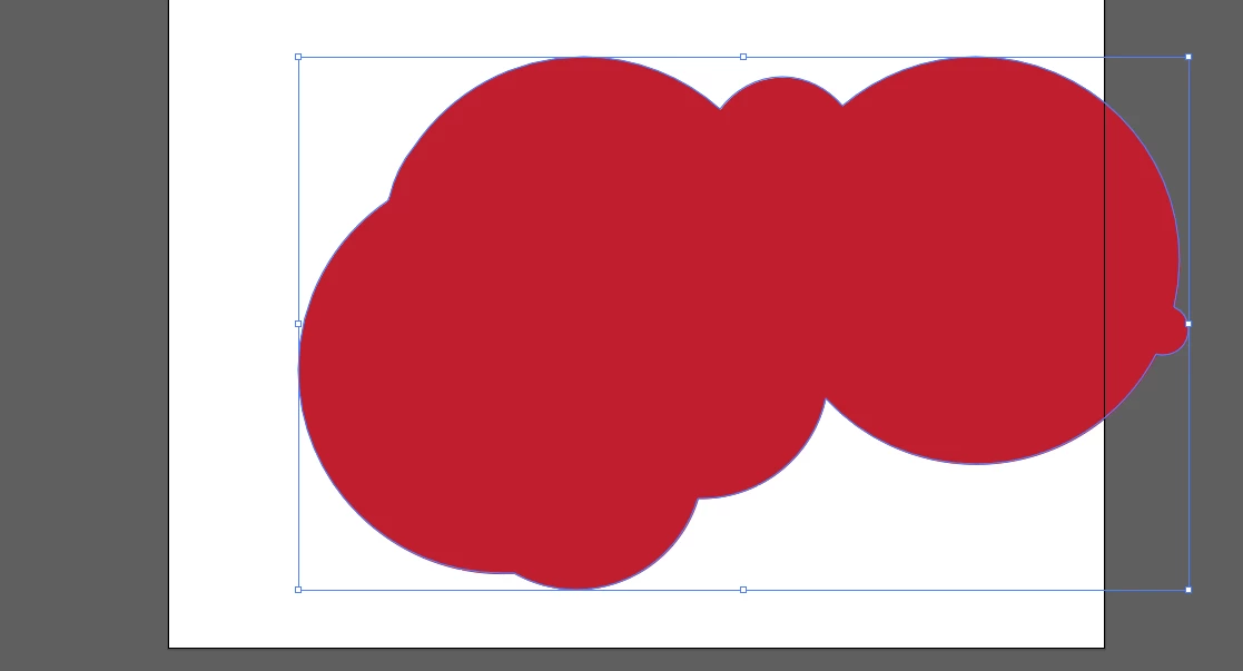

I am having similar problems as described above - I cannot merge shapes to create a new shape. I have drawn a whale using circles, but when trying to fill the colour it fills all the circles? I am quite new ti illustrator so thinking I may have missed a step along the way...any advice would be gratefully received!
Monika Gause
September 25, 2017
Use Live paint or the shapebuilder tool.
