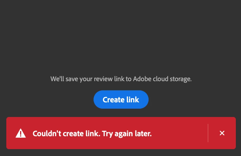

Share for review not working in Illustrator "couldn't create link. Try again later."
Share for review works on both Photoshop and InDesign. I've updated to current version (29.4).
Things I've tried to fix:
  • Tried other files thinking the file was maybe corrupt, same result
  • Uninstalled and Reinstalled Illustrator
  • Restarted
  • Loged out of Adobe CC

I’m facing the same issue. I’ve tried logging out and logging back in, but it hasn’t worked. I’ve attached the screenshot for reference
