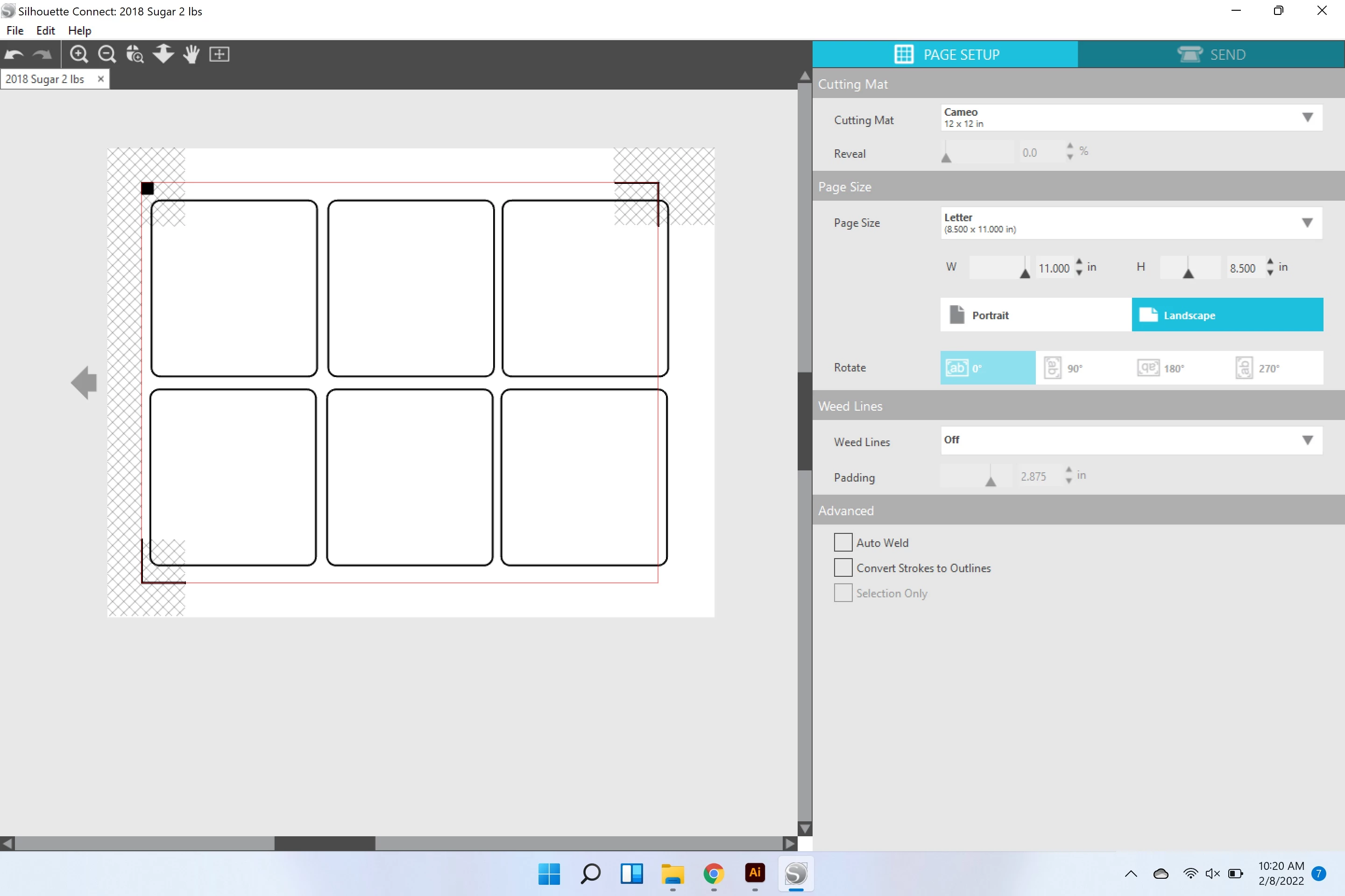

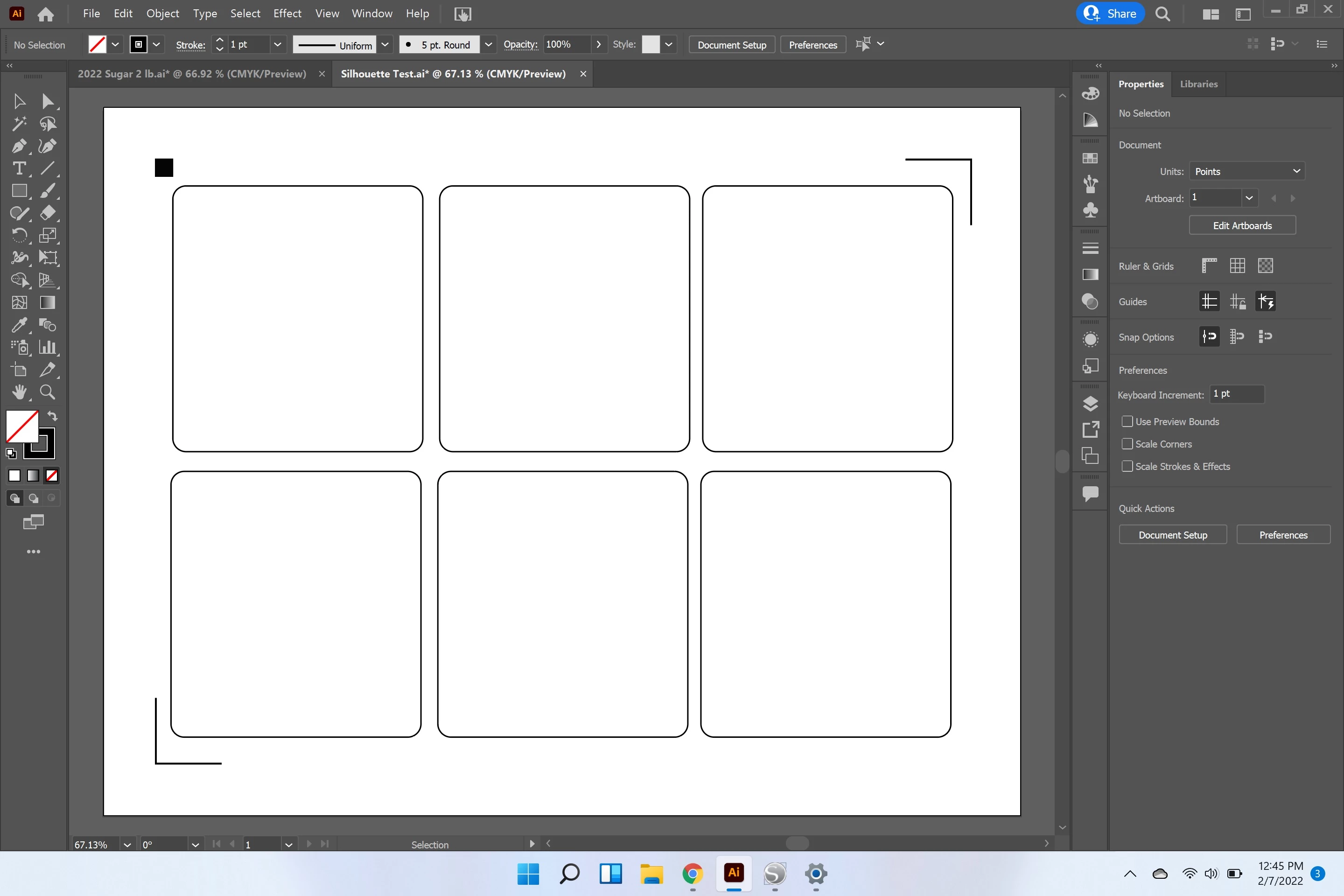

Hello all - I am using a plugin for the Silhouette Cameo  craft cuttter. I have the latest version from Silhouette (1.6.066.001), which says it has been updated for Illustrator 2022. When I "Send to Silhouette Connect" from Illustrator, the registration marks show up in the wrong place in Silhouette. They don't match what's in Illustrator or what was printed. It is literally impossible to get the cut right when the marks are off. I have tried making sure I have the mat selected correctly in Silhouette - in fact selecting any mat of any size in Silhouette does not change the placement of the registration marks on their page. See attached pics. I have spent days in a frustrating customer support spiral over this. Is anyone else having this problem?

Update as of July 17 - 2022. Silhouette DOES have a new Beta version of the Connect Plugin available, and it does seem to correct this issue. Version 1.6.107 is the new one.  It doesn't say anything about it fixing this bug, only support for CorelDraw 2022 and something about licensing, but I tried it nd it works. You have to go to the software downloads page, select "More Info" on the Connect Plugin choice, then select "Download Beta Versions" in small print. Them you will be presented with the download for it.  Seems to work fine in this version, with Illustrastor 2022. Finally!
