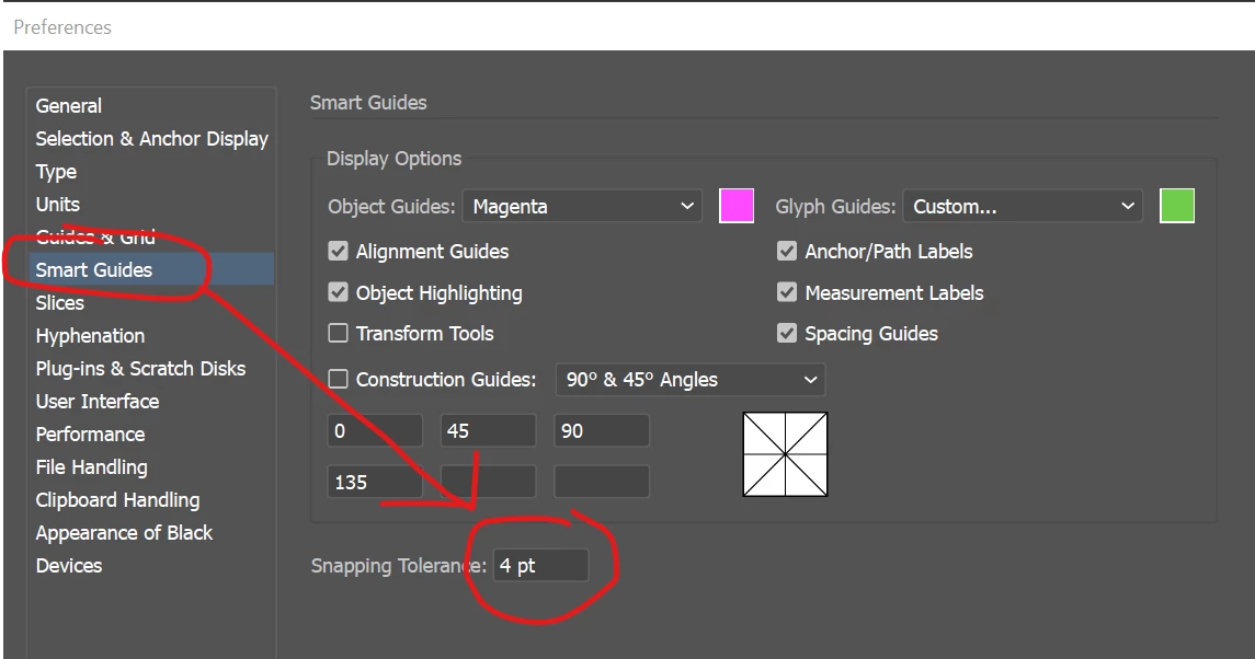

enable smart guides
view >> smart Guides
then grab by the point and drag it will snap based on snapping tolerance  set ehre
Illustrator is very advanced in snapping, you can also snap to glyphs now. Here are where all your options are

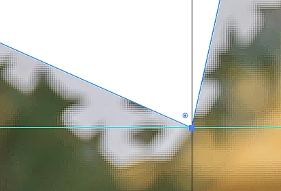

so far it seen snapping but only when magnified at pixel level, otherwise not working, and automatic guides do not appear.
mirafotoAuthor
April 21, 2022
in another corner of the shape snaping did not work, so control point and clipping mask vertex did not snapped to the page corner, I did not known this until magnified. Vertex did not want to snap to the intersection of the guideline and page no matter I try. everytime I magnify more I see it is missaligned.
What I am trying to accomplish is shown in another image, I want clipping mask for metal gray plate (jpg image) above portrait to be same shape and size as a table below. It is simplest task, which seem to be difficult in Illustrator.
