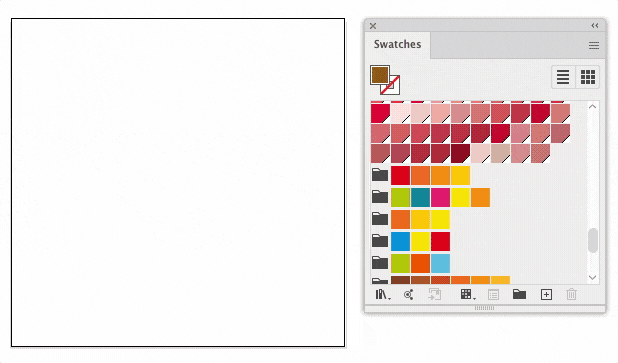

Upd 20-07-2023: You can now create a legend for selected swatches in the Swatches panel.

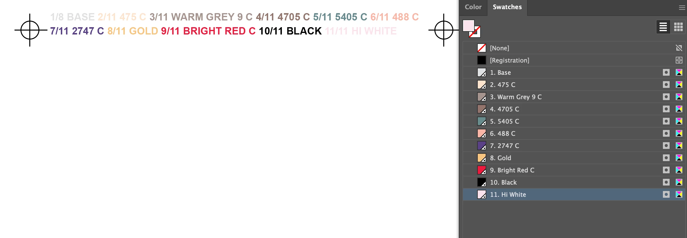

  Output swatches as a line of text, with each name colored with the swatch
  Discussion: https://community.adobe.com/t5/illustrator-discussions/simple-script-is-it-possible/td-p/13944314
  Author: Sergey Osokin, email: hi@sergosokin.ru
  Check my other scripts: https://github.com/creold

If many swatches, the script may run slowly.

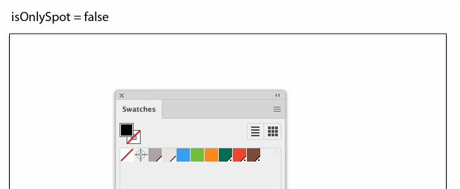

Upd 19-07-2023: Added boolean flag isOnlySpot to output all swatches or only global / spot colors.
