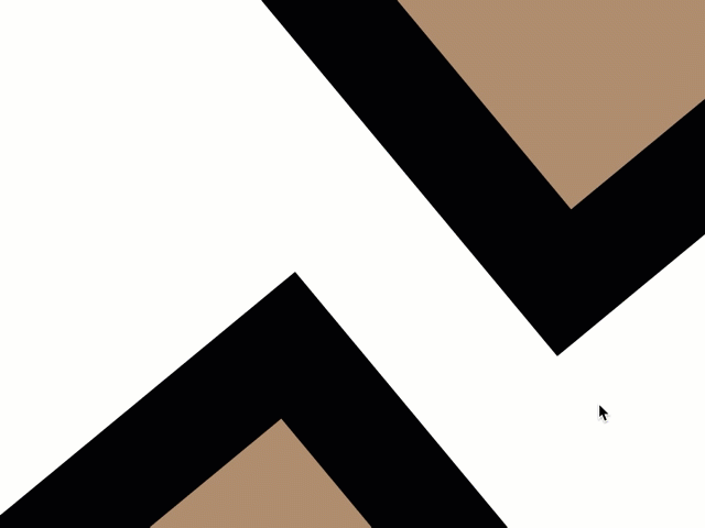

I don't even know how to explain this issue. I walked away from my computer the other day and when I came back it was snapping fine when I changed literally nothing. Now it won't snap nodes together once again.
VIDEO: https://youtu.be/3SlIFMm0-Fk

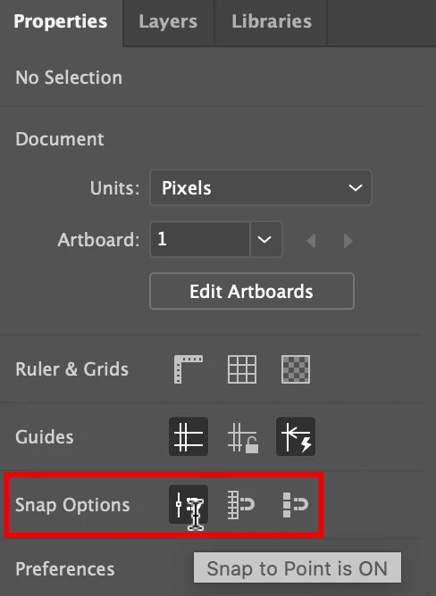

May 11, 2022
With nothing selected, you can access some Snap Options within the Properties panel.
You can also access the Snap options near the bottom of the View menu.
