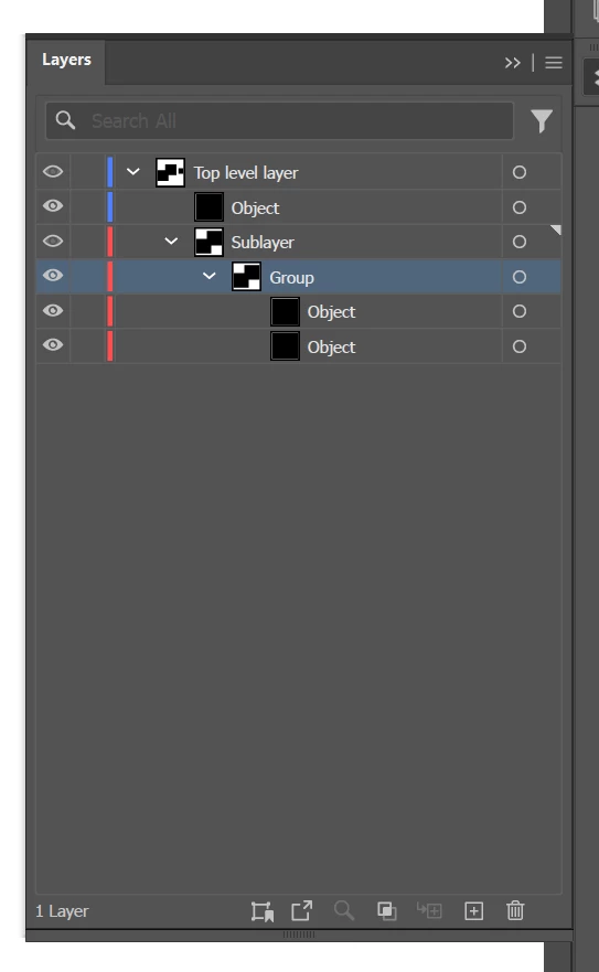

    It works fine on sublayers. But not objects or groups:
    June 24, 2025
    Interesting. But it doesn't work for me on any sublayers. I tried command clicking on every sublayer and every layer within those sublayers, and nothing. Command clicking just turns them off. But it works fine on regular layers.

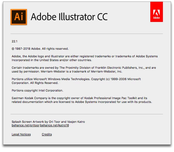

    does the eye icon in layers turn into an outline when you ctrl/cmd-click it? do you see 'outline' in the document's tab/title bar?
    i'm not having a problem with it in AI 22.1, Win 10

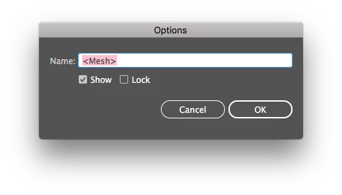

    Nope.  Command+Clicking the eye icon only turns the visibility of the layer off - as if it was normally clicked. Double-clicking the layer brings up layer options but the Preview selection isn't there.

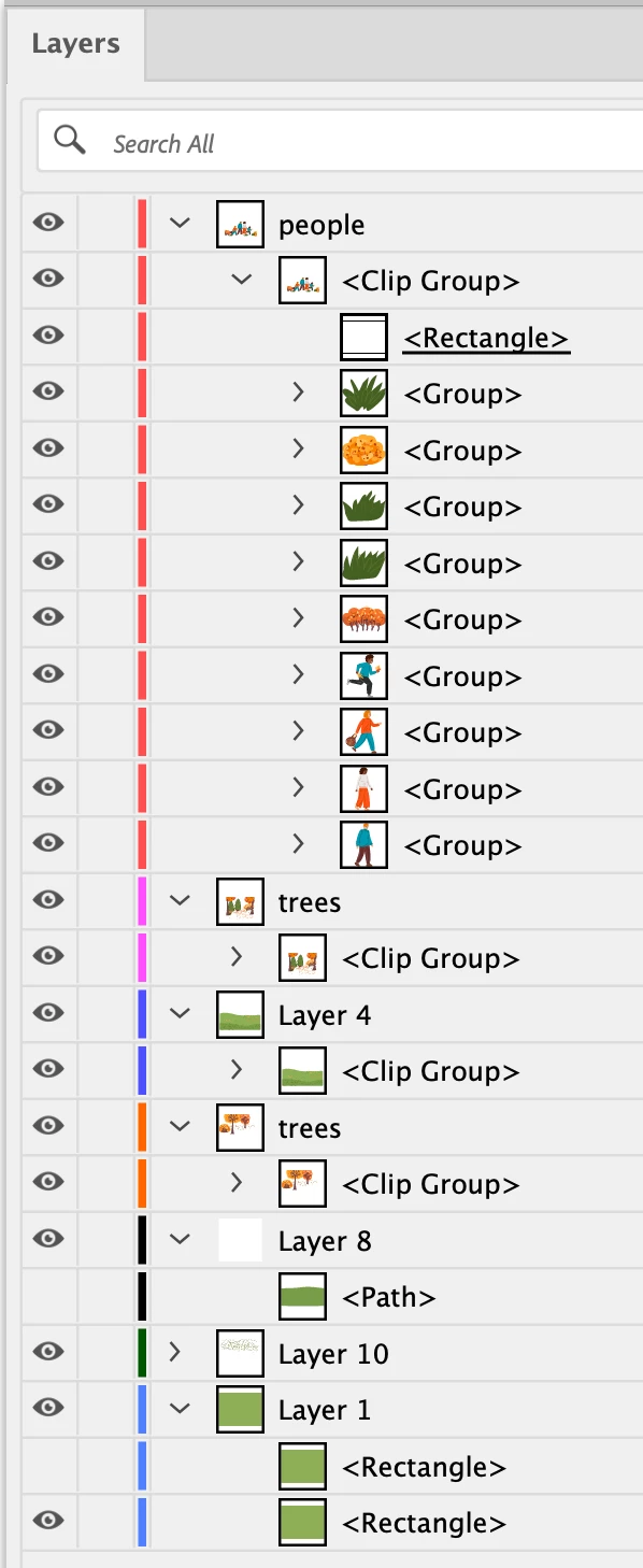

    April 26, 2018
    that looks like you're selecting a group or other object, not a layer.
