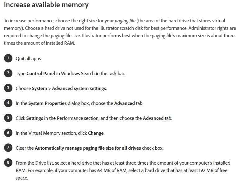

Apr 1, 2025 2:48 PM UTC
'Increase the Available Memory' (https://adobe.ly/3YdnwNR) solved the problem of long waiting. Now is really fast. Thank you, @Anubhav M .
