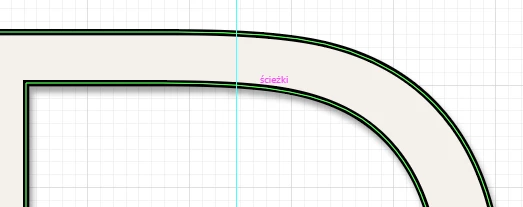

Hi Guys,
I am trying to create a simple logo in Illustrator, and I am facing two problems.
I just can't understand how to correct this logo so there won't be any visible pixels. For example I tried "smooth" tool I think, but it didn't help.
This is like my first adventure with vectors graphics and I thought that it would be much easier to scale things and create simple objects. Other obstacle that appeared is exporting the file to JPG. From what I have read it mostly depends on the PPIs, buuut there is another question coming... what PPI should I set to get a good quality and a final image in 180x180 px (for example)?
I did a lot of research to find a solution for my "problems" but non of it worked for me. I hope that someone would be able to support me here!

March 23, 2020
Tomasz,
The bit shown presents no issue in terms of smoothness of the original vector artwork itself, so maybe a more troublesom part, if any, may be needed for suggestions.

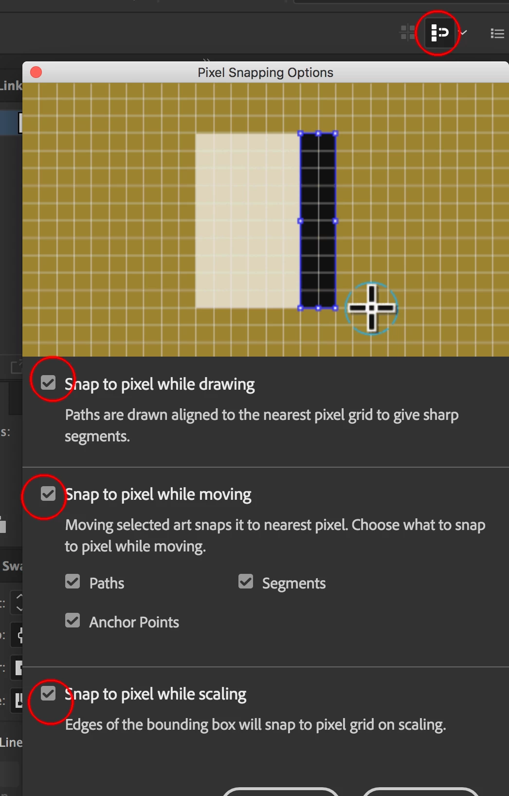

Mike_Gondek10189183
March 22, 2020
What are you using this for, if for a website you can use .svg format.
As mentioned pi does not matter as you already have your final dimensions of 180 x 180px.
If you are going to ,jpg, make sure you turn on snap to pixel, so your pixel fall onto the grid and  reduces softness.
