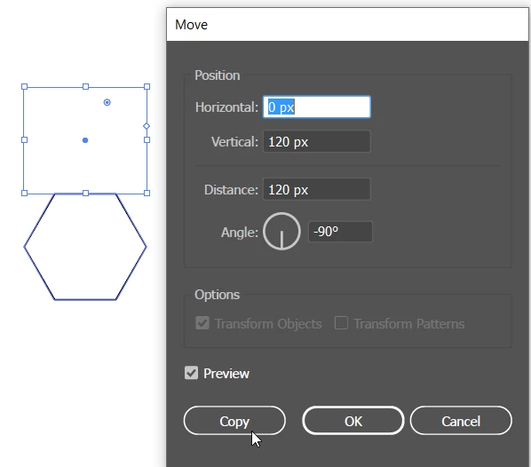

A workaround would be to draw one polygon. Select it and note the height of the polygon.
Choose Object > Transform > Move. Enter the height measurement and click Copy.
Select both objects and rotate to the angle that you need.
