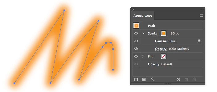

I was wondering if the is a soft circle brush I can use? Like I know there is one in Photoshop, but is there something like it here?

    You can try to make a round Calligraphic brush.
    Give it a Gaussian Blur, if wanted,change the opacity and blending mode.
    Save as a Graphic Style.
    Be aware that the result may have to be rasterised to print (just like with Bristle brushes).

    This worked! Thanks so much. now how do I save it so that it's always available and I don't have to put in these settings every time?

    You can add it to the Graphic Styles and save the Graphic Styles from the menu Save Graphic Style Library.
    But because Graphice styles libraries are just Illustrator files (like other libraries as brushes, swatches and so on) you can open any Illustrator file that contains that Graphic style from the Graphic Style Library menu.
