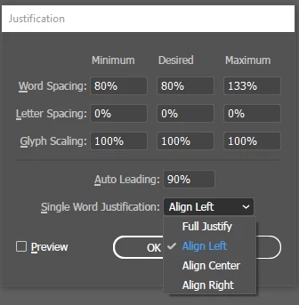

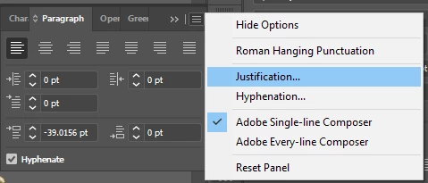

I just ran into this issue and in my case, I didn't make an update. Here's the solution that worked for me
1. Click on the menu icon on the paragraph panel
2. Click on Justification
3. Change the single word justification from full justify to Aligh Left
4. That should solve the issue

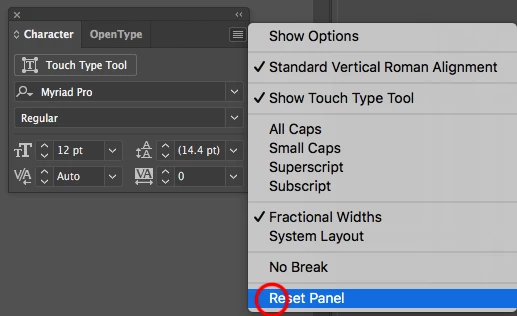

  • Have you tried the flyout menu  and chose reset panel for both character and paragraph?

Angelic_Smile5D2E
February 15, 2022
Thanks Mike!
I had the same problem in Illustrator CC 2019 with the space bar key not working. After I did the reset panel it started working again.
