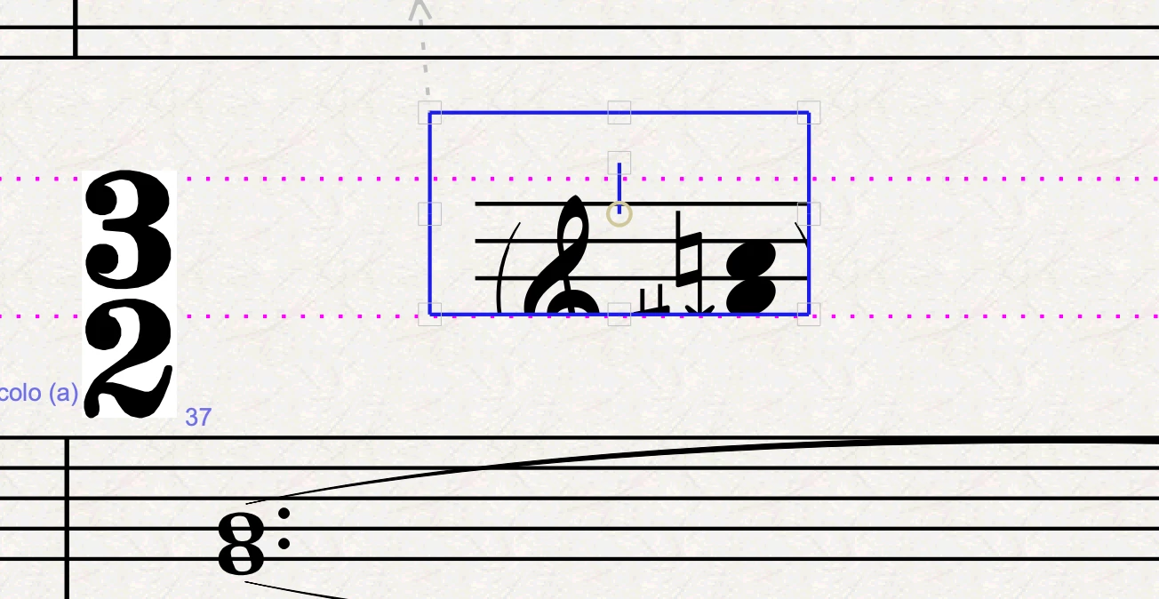

Attached below you will find three files. The "4-b1_3-DB" and "4-b5_7-DB" ones work flawlessly. They have been exported from Steinberg Dorico through a feature called Graphical Slices which lets you draw a rectangle around something and export just that in the desired format. I exported them, opened them in Illustrator, File > Save As, selected SVG, in the settings states 4 as decimal places, 1.2 Tiny as standard, unchecked Responsive and hit Save. In Sibelius, the import has been perfect!

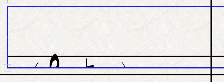

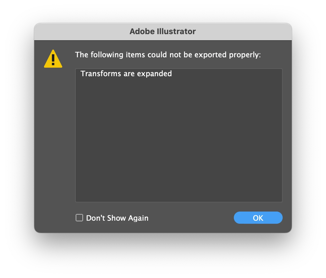

Now, could you please help me understand why the file "4-b32-Vc" is not behaving as well as the other two? Upon opening it in Illustrator I can see the whole staff (5 horizontal lines protruding at each side of the figure) and, even if I fix it to how I want it, I get the error "Transforms are not expanded".
I have tried everything I know to fix this but I am now completely stuck because, when I import this new file into Sibelius, it is missing its bottom portion, and looks like this:

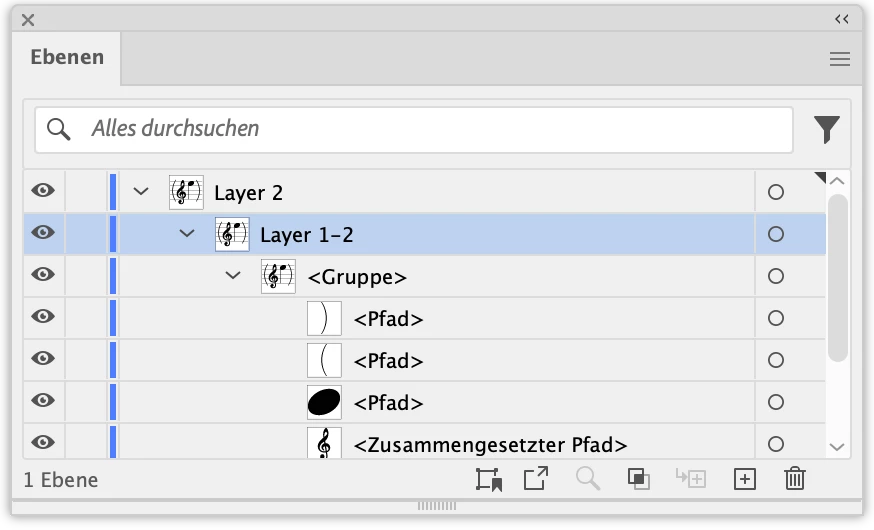

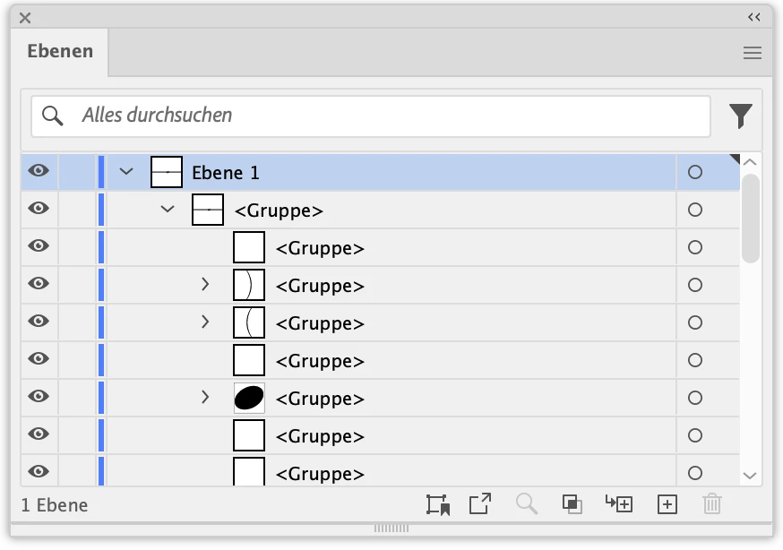

Monika Gause
August 25, 2025
The b32 file has a different structure than the other files.
Those have an additional group that the b32 file does not have.
But that workflow of going back and forth with a file format that Illustrator does not fully support, is not sustainable.

Monika Gause
August 25, 2025
This is the difference: Your b32 file does not have that element which is called "Layer ...")
And yes, Illustrator does not fully support SVG. There are always things that do not work.

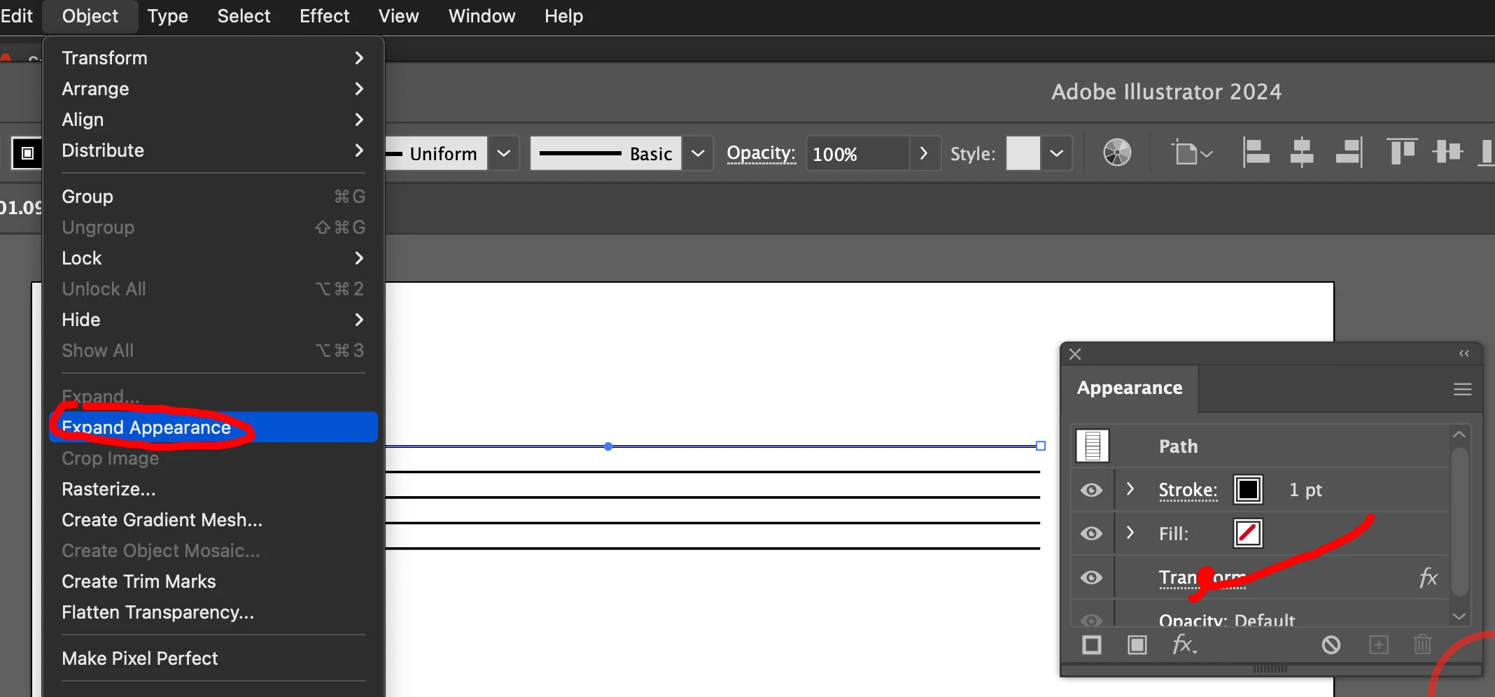

Mike_Gondek10189183
August 25, 2025
You probably have some type of transform effect on a vector object. Select the object. Object >> Expand Appearance
August 25, 2025
I've done that and still it exports wierdly in such a way that the receiving program places it cut of some part of it.
Any other idea?
PS: it seems that I had Scale Strokes & Effects checked but, upon unchecking that, the improvement is modest.
