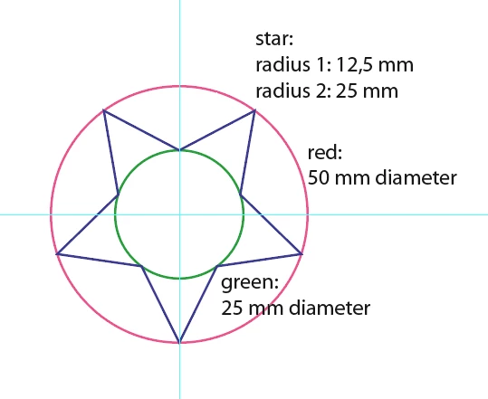

I understand theoretically that radius 1 in the star tool controls the distance from the center of the star to the outward points; radius 2 controls the distance from the center of the star to the inward points. But I've experimented and researched, and I can not understand it. The numbers I put in do not seem to align with this understanding. I was hoping you could explain this to me more. The only pattern I really see is that when radius 1 and 2 are close together, you get a more default star; when the numbers are far apart, the star is very pointy and the center is small.

Can you please screenshots with measurements and then tell us what exactly you don't understand?

Monika Gause
November 5, 2019
Does this clear it up?
