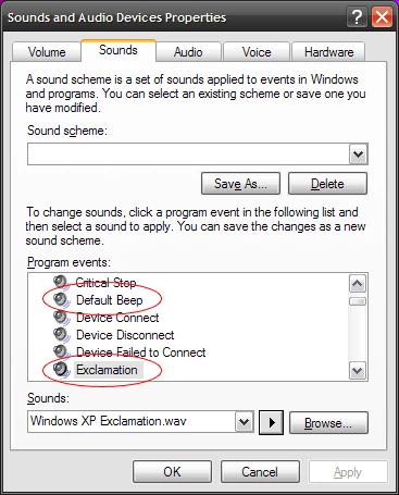

windows users can goto the sound panel and deactivate the beep. I personally have never heard it... so idk what beep it is.
but its one of these two...
maumorenob
May 23, 2020
Yes, you have it here, actually is the "Default Beep", that beeps in Illustrator.
I deactivated and works, no more beep.
