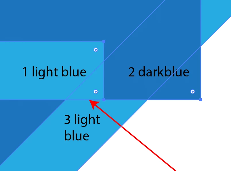

In AI, I have two similar objects overlapping. One at an angle.
In the places where their similar colors intersect, there is a tiny tiny border. Is this due to an antialiasing bug, and how can this be prevented?

As long as you have no control over how a viewer/browser is going to render this, based on how this is currently constructed, you will always have the chance of the "line" showing up. Vector objects are rendered from the bottom up, so as lomng as you have the light blue and dark blue stacked, even exactly posotioned, the dark blue can "peek" through.
To elimiante it when generating an image format, like PNG, instead of rendering at screen resolution directly, export it first at high-res (say, 300), with NO anti-aliasing, then downsample in Photoshop to final desired resolution.
Orrrrr.. you can modify the file... like so:

And it depends on the browser how much is visible of the anti-aliasing in the svg. Firefox on my Mac shows less than other browsers.
Ton Frederiks
Sep 25, 2021 8:28 PM UTC
It is the stacking order that causes the anti-aliasing artifact.
The 2 dark blue shape is sandwiched between the light blue 1 and 3 shapes.
As suggested moving the bottom part of the dark blue shape upwards will solve the problem.

Thank you for reaching out. I checked your file, and here are my observations. I hide the bounding box, smart guides, edges & switch to pixel view, and it looks like there is a tiny gap in decimal between the two elements. That's why that hairline is visible. If I press the arrow down key once it disappears. @Monika Gause, is this the case? Could you please confirm? I hope it helps!

And since this is getting worse in SVG export, then I would assume that the Decimals (precision) is causing it.

It's an anti-aliasing issue that usually only affects the display on screen. But when exporting the pixels you might have it as well.
In order to get rid of it, either unite the objects or overlap them.

They are overlapping, though. And I do see it when exporting to an SVG.

SVG options can totally mess up your artwork. Even when the objects are overlapping.
