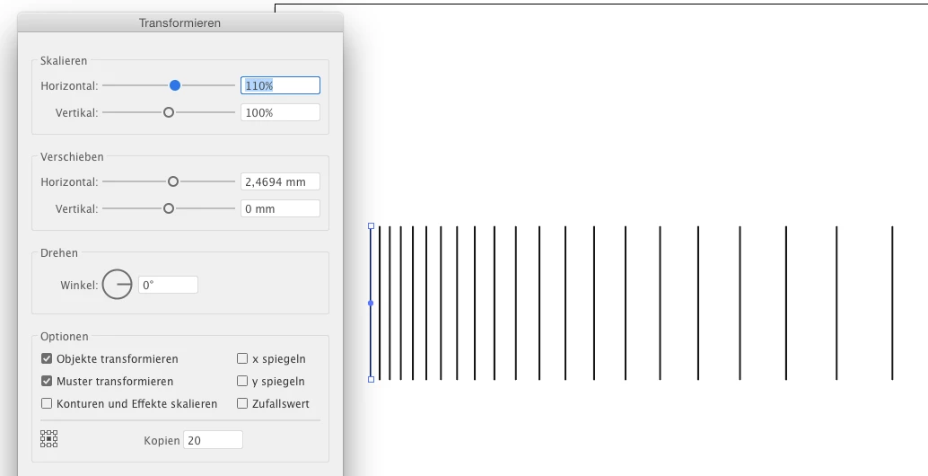

A vertical line and then use the transform effect on it:
Sorry for the German interface, but you just can compare the boxes in your version. The checkboxes are important as well. Adjust the values to your needs.

Do you know if this can be applied along a stroke? The bridge bends so ideally I'll be applying this effect along a stroke.
a1exa
Monika Gause
May 3, 2019
You can expand the appearance (which gives you the strokes) and then create a brush out of it.
