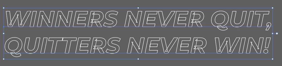

Stroke overlapping in text.
Can anyone tell why this stroke overlapping is happening, it just started doing this recently in illustrator. Before this never happened and it is happening with almost every font type I use.
I tried fixing it but I am not able to else I have to lose the editability.

Expanding to Object and using Merge in Pathfinder tool worked for me

Feb 15, 2023 6:58 PM UTC
There have already been a few posts on this topic in the past. However, most of them were about variable fonts.
Two good suggestions have already been given by @Kurt Gold and @Ton Frederiks. These are solutions that have helped in the past.

Feb 15, 2023 5:20 PM UTC
Another way would be to give the text no stroke or fill and add a new stroke and fill in the Appearance panel.
Move the stroke below the fill.

Feb 15, 2023 8:32 PM UTC
and I think you'll need to have Pathfinders "Add" effect too...
Feb 15, 2023 8:39 PM UTC
It may not be necessary if the stroke is moved below the fill. The fill would hide the overlaps. Still, using the "Add" effect wouldn't hurt.

Feb 15, 2023 5:16 PM UTC
This is probably a variable font. Check if there is an update for the font or use the trick that Kurt suggested.

Feb 15, 2023 4:45 PM UTC
Every font?
So you are not applying any effect or transformation to this - like offset path?
What font is the sample?
Feb 15, 2023 7:38 PM UTC
The typeface is the Variable version of Montserrat Italic (available via Google Fonts). The overlaps are normal in the Variable version. Some OTF Variable fonts I've purchased don't appear to have any overlaps at all (TT Supermolot Neue would be one example). Others may have lots and lots of overlaps (Helvetica Now Variable is one example). I don't know all that much about how Variable fonts are created, but it seems like the overlaps are an often necessary feature. They seem to work off the same principals as a blend operation.

Feb 15, 2023 1:18 PM UTC
akash,
"and it is happening with almost every font type I use"
Maybe you are mixing with the wrong types (sorry, I was stronger than I).
With regard to the why, it seems that we are looking at the (cunning) way of building the letter shapes which remains in the form of (sloppy) leftovers instead of making a final version with letters consisting of single paths of outer boundaries.
You can say that it has the advantage of (potentially) making it easier to edit the font(s)/letters.

Feb 15, 2023 7:28 PM UTC
The lettering in the sample image was set using the OTF Variable version of Montserrat Italic. Stem overlaps are a common feature to many (but not all) Variable Fonts. The overlaps can be a production hazard in some work flow environments where the letters will be cut out of different materials.
One option for getting rid of the overlaps: use a "static" style of Montserrat Italic. If you downloaded Montserrat from the Google Fonts web site there should be a subfolder containing a bunch of static, non-variable font files. The static fonts don't cover all the weight possibilities of the variable version however.
Like Kurt said, you can use Pathfinder operations to fill in the overlaps. This would involve converting the text to outlines. If the Pathfinder operations don't fill over the overelaps, check the Attributes palette for the correct non-zero winding settings (I learned about that a long time ago when getting rid of overlaps in line strokes that were expanded into raw outlines).
If the text needs to be editable Ton's suggestion of adjusting the stroke and fill in the appearance panel would work.

Feb 15, 2023 7:52 PM UTC
Not quite, Bobby. The Pathfinder effect does not involve converting the type object to outlines. It will still be live and editable text.

Feb 15, 2023 11:26 AM UTC
Try applying the live Pathfinder effect "Add" to the type object (see Effect menu).
