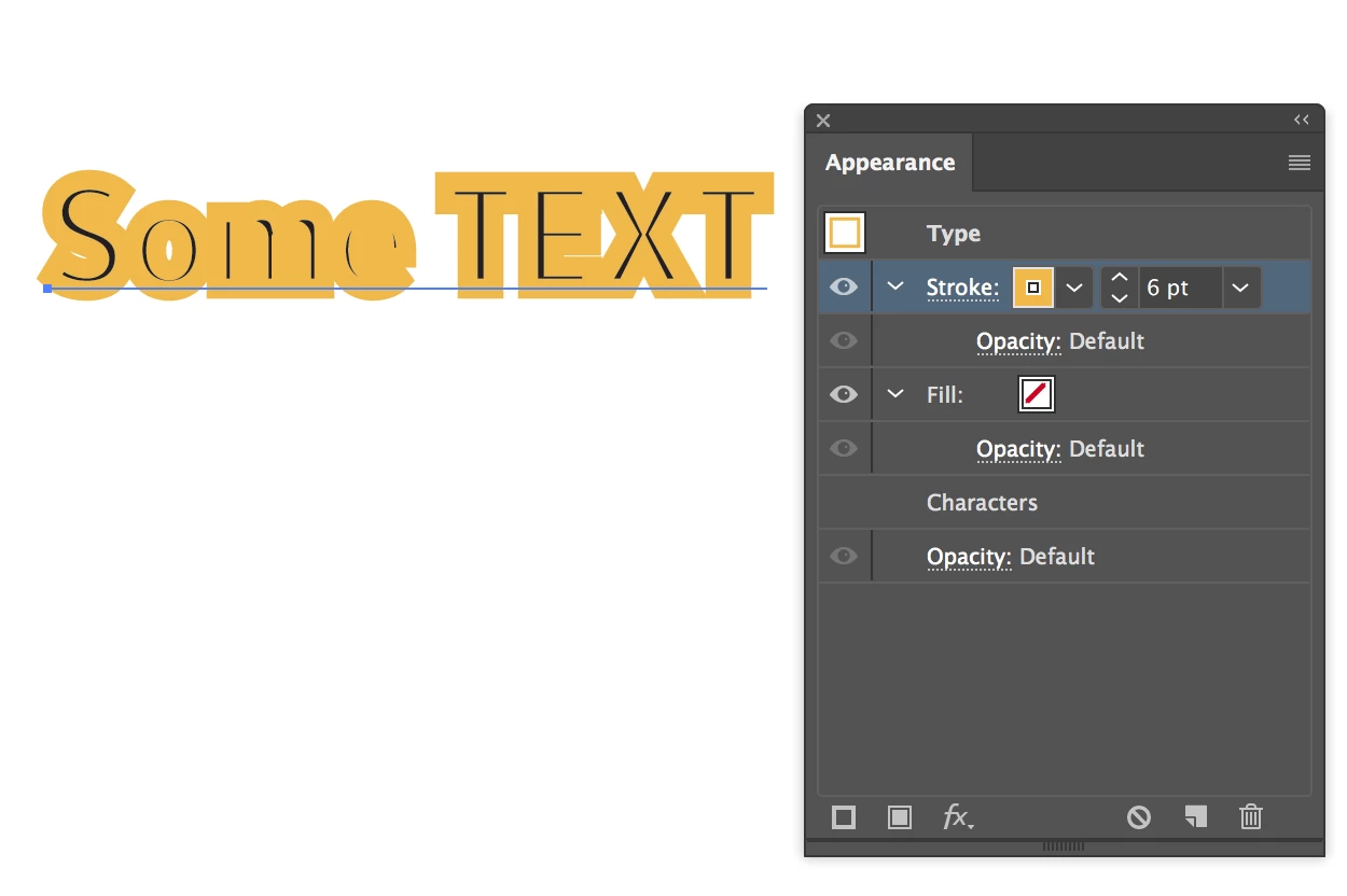

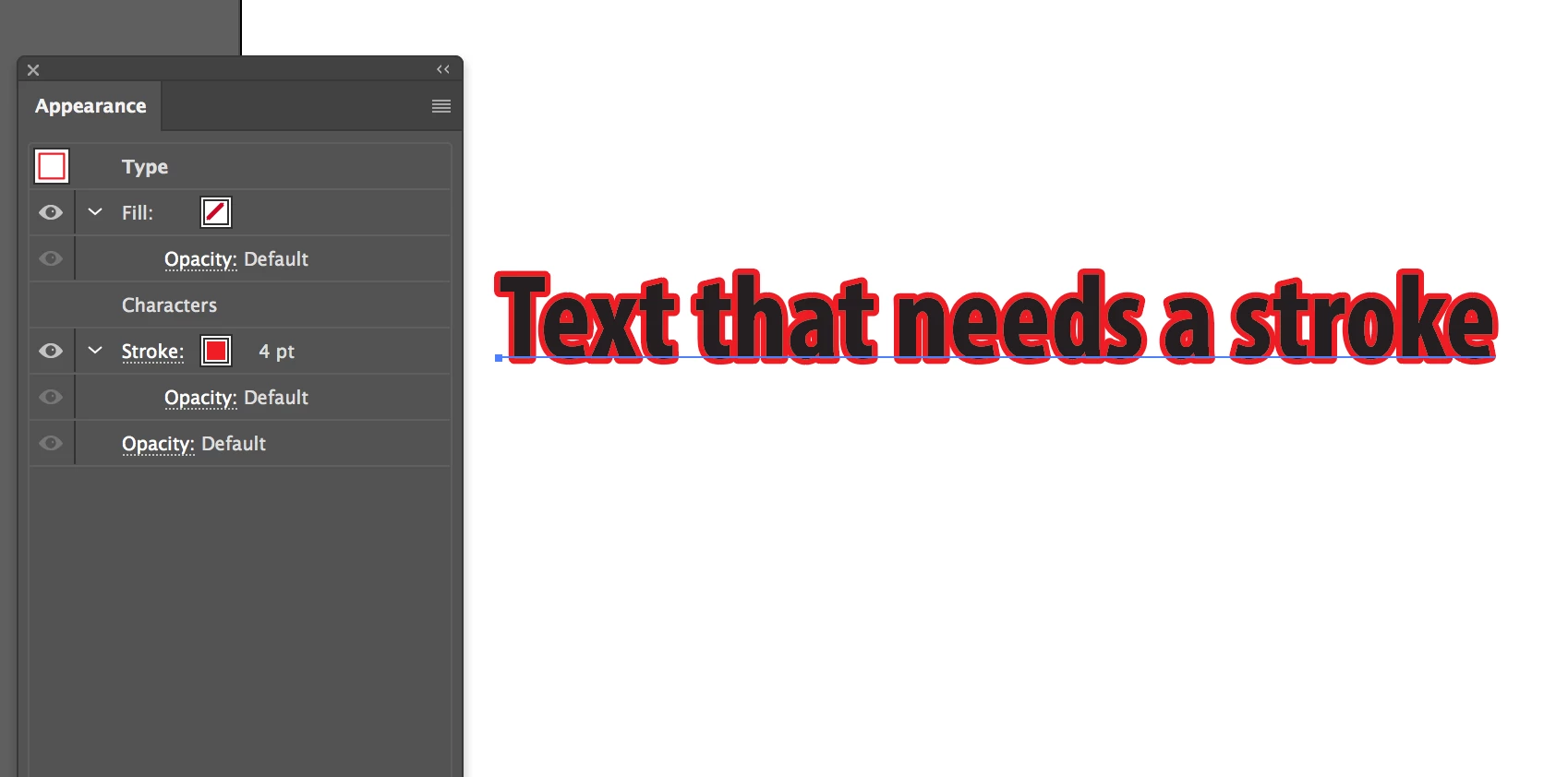

I think you are missing one step in the instructions.  After you add the stroke to the Text object in the Appearance panel, go into the panel, grab the stroke line by its right side, and drag the stroke down below Characters.
Both of the examples below are of the same live text. The second one is after I moved the stroke down in the panel.

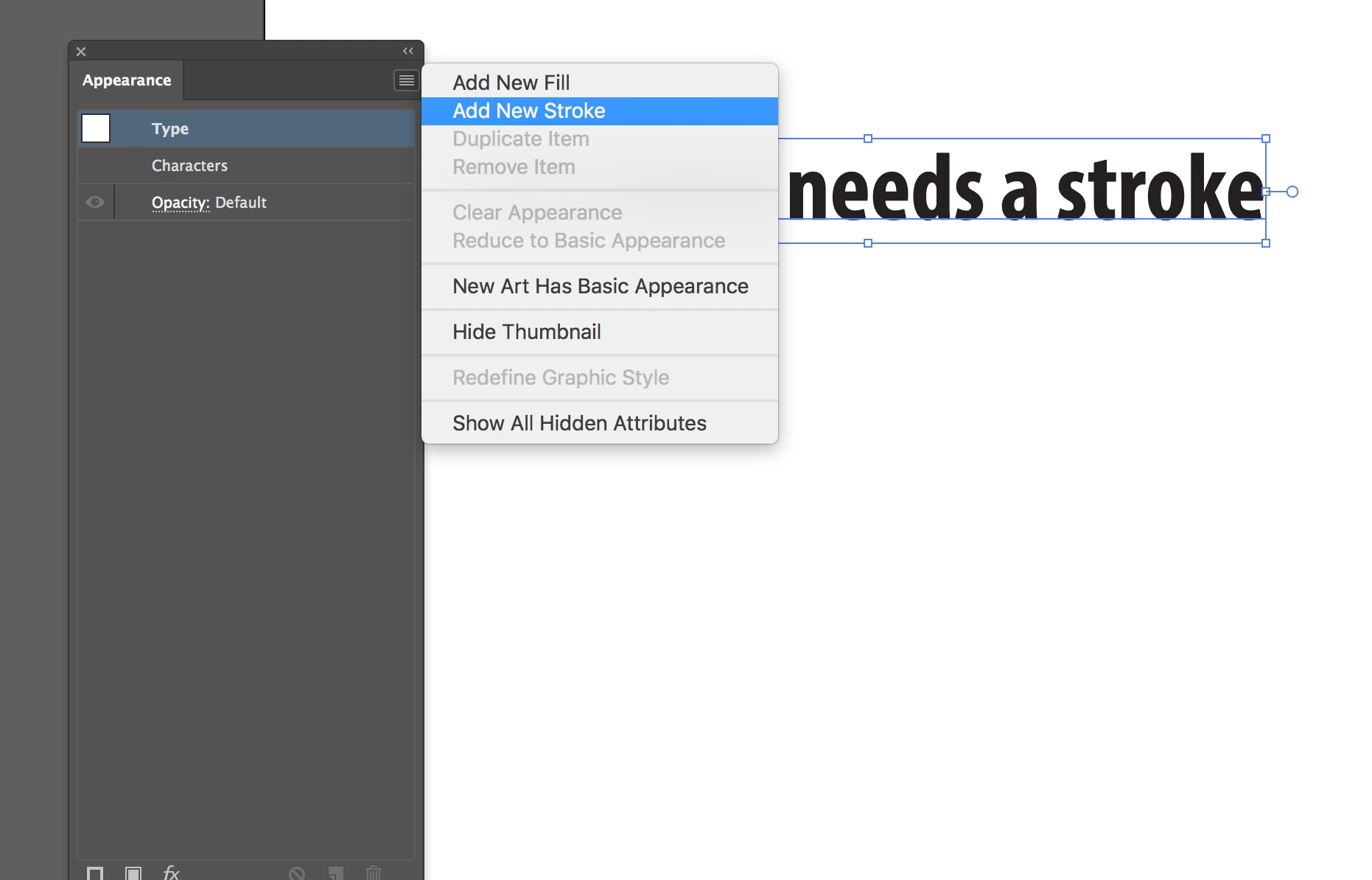

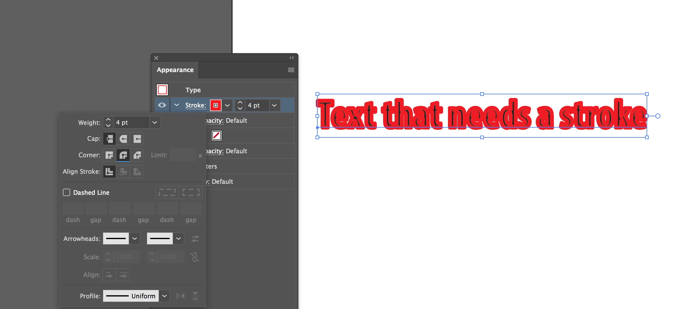

Here are some screen shots to help illustration method that needs just one instance of the text.
Note that the stroke has to be added in the Appearance panel, and that it is added to Text, not Characters.
Using this method with increasingly large strokes can allow many strokes to the added to the same text object.

ok i just found it, it looks a bit different but is in the stroke flyout of course
http://files.2he.com/uploads2/2012-10-30--03-22-12.jpg
http://files.2he.com/uploads2/2012-10-30--03-18-01.jpg

Frank,
The way I (mis)understand the question, you can make it with live Type this way, using the Appearance panel:
1) In the flyout (upper right arrow) tick Add New Stroke,
2) Set the Stroke Weight to twice the desired value,
3) In the main window drag the Stroke down below Characters.
This will set the stroke(s) behind the lettershape(s) so you only see the outside half of it.
