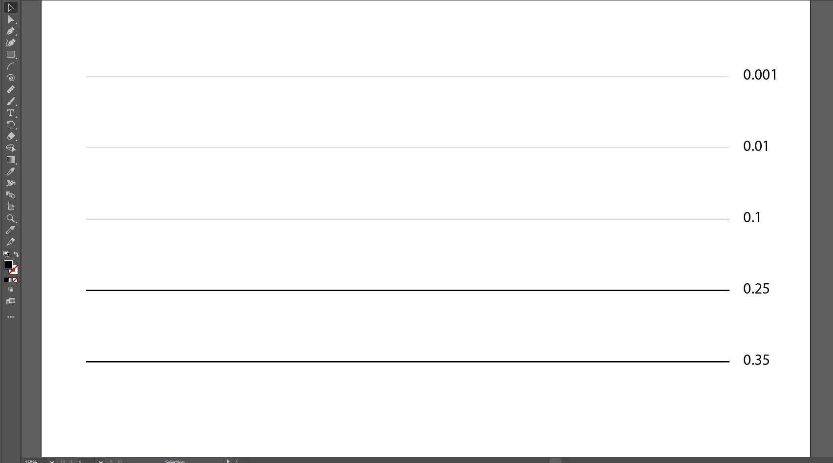

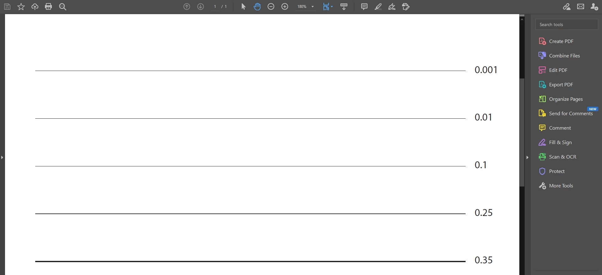

I want to have very thin lines, below 0.1mm. While in Illusatrator, the difference in stroke it noticiable, but when exported to pdf and viewed in Acrobat, all strokes below 0.1mm including 0.1mm look the same.
How can I fix this? Thanks

Hi, ShynnSup.
To try it out, open the "Preferences" panel in Acrobat and uncheck "Enhance thin lines" under "Rendering" in "Page Display".
ShynnSup
ShynnSupAuthor
September 1, 2020
Hi, this worked! But, is this a PC-dependant setting? I want to send my document through mail and want is displaying correctly on the other side. Can I hard code this setting into the PDF?
Having to tell the client to turn this off is a big no-no for me.
Doug A Roberts
September 1, 2020
No, it's entirely a user preference. As far as I know it's not even scriptable.

There is no reason to have a line less than 1 px in web, or .01mm in print. Why do want lines so thin that they are thinner than what a digital screen or printing press can reproduce? If you are going to print what screen Anilox roller do you plan on using?
ShynnSup
ShynnSupAuthor
September 1, 2020
Clearly in my first screenshot there is a difference between 0.1mm and 0.01mm. That's what I care about.
