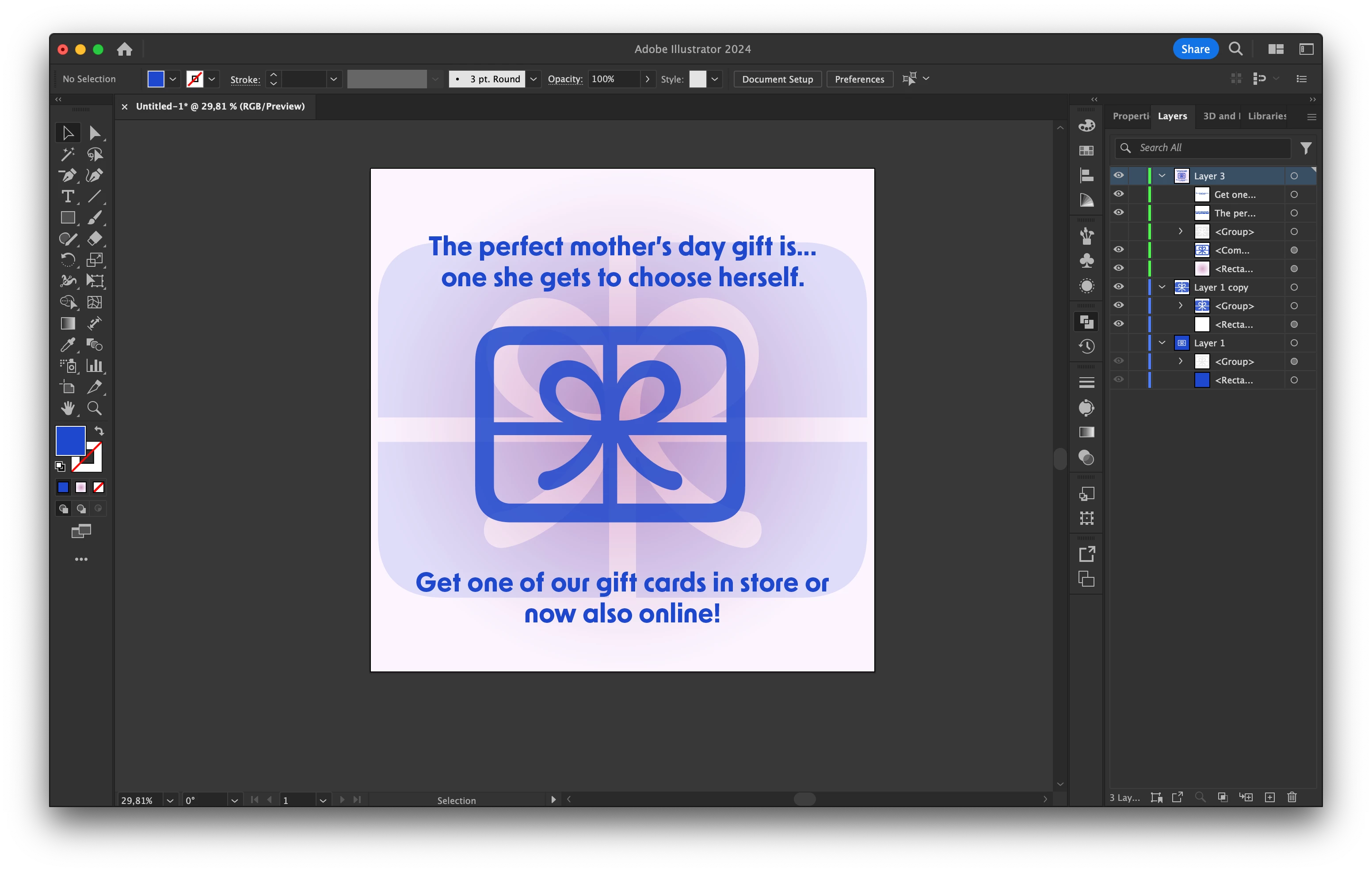

Hey guys,
Super weird situation so hopefully someone knows whats going on.
When I started up Illustrator this morning and started my project I noticed that everything appears transparent, I'm able to noticebly see my underlying layers while everything is at %100 opacity.
I didn't change any settings or do an y updates since yesterday and haven't experienced this before this morning.
Thanks in advance.
Emanuela
Correct answer Ton Frederiks
There are some objects that show a filled dot at right side of the layer panel. that means they have a transparency setting.
Select them and check the Transparency or the Appearance panel.
