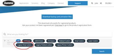

    After reading this and many more posts I managed to find a version of Summa Illustrator plugin. It works with my version of Illustrator 26.2.1 (64-bit)
    I have not updated to 26.3 as it has given me many other bugs!
    See below link to official Summa site and also a screen shot of the site. You can find it in "Legacy Vinyl Cutters" under "Summa Cutter Tools" 3rd one down the list of software.
    Link to legacy applications (Even though supporting CC 2022 Illustrator 26.3 up.....!?)
    https://www.summa.com/media/huzp2ja0/setupsct.exe
