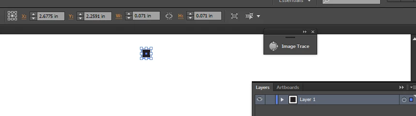

    The code I posted produces a sunflower in the following way:
    1.  Create a small square using the Rectangle tool
    2.  Open the Script (.js or .jsx extension) that contains the script above and run it.
    3.  You get the resultant picture
    I was able to get this result with a little knowledge of ActionScript and refactoring the code to JavaScript using the JavaScript for Illustrator Reference Manual that is available online.  It was tested using CS6 but I think it will work in CC as well.

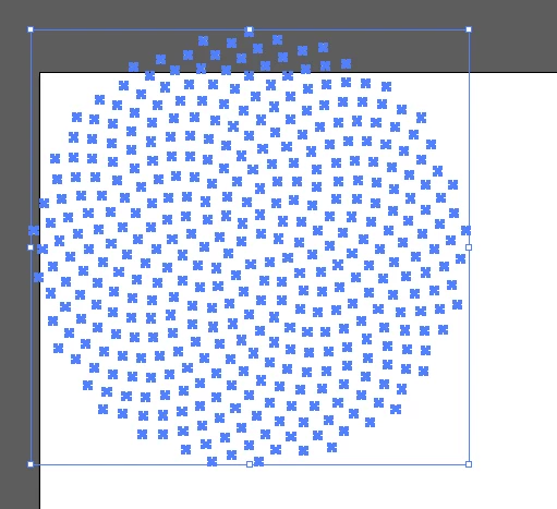

    Some Code for you (Javascript for Illustrator)
    var docSel=app.activeDocument;
    var docSelSel=app.activeDocument.selection[0];
    //translate([deltaX],[deltaY]);
    for (var i=1; i<400;i++)
            var r=10*Math.sqrt(i);
            var t=137.5*Math.PI/180*i;
            var newSel=docSelSel.duplicate(docSelSel);
            newSel.translate(r*Math.cos(t),r*Math.sin(t));
    docSelSel.remove();

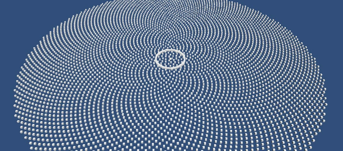

    December 31, 2013
    you can try this and this
    http://mathematica.stackexchange.com/questions/20924/spiral-pattern-and-fibonacci-numbers
    and
    function phylo ( N:float,k:int):Vector3{
              //N=numpts  k=currentpt
        var inc =  Mathf.PI  * ( 3 - Mathf.Sqrt ( 5 ) );
        var off = 2 / N;
              var y = k * off - 1 + (off / 2);
              var r = Mathf.Sqrt (Mathf.Abs(y))  ;
              var phi = k * inc;
              return Vector3(Mathf.Cos(phi)*r*10, 0, Mathf.Sin(phi)*r*10);
    i only do the look upt till N/2in the above formula i use N/
    this is perhaps even better:
    function sflo ( N:float,k:int):Vector3{
    var n = k;
    var r=Mathf.Sqrt (n);
    var t=137.5*pi/180*n;
    return Vector3(r*Mathf.Cos(t),0, r*Mathf.Sin(t));

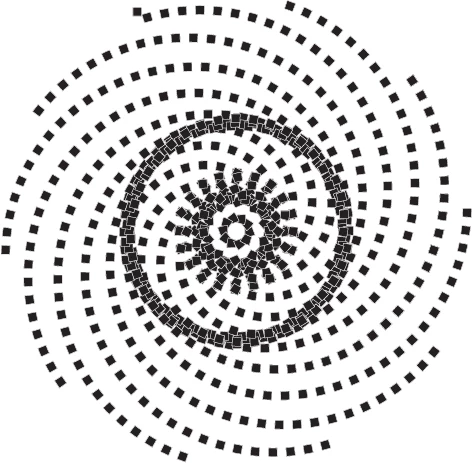

    markerline
    December 24, 2013
    Here's a second attempt, this time using an Arc instead of a Spiral.  The problem I seem to be having is near the origin where items are bunched together as opposed to evenly-spread-out.

    markerline
    December 24, 2013
    Monika, your method may solve the problem I'm having with the origin.  However I notice a very apparent linear pattern radiating from the center, which is not what the floral pattern does in reality or according to the mathematical depiction that Jacob pointed out in the wiki article.
    markerline
    December 23, 2013
    That's the image I was trying to create Jacob.  I've done it in Flash before (somewhat closely anyway) But never Illy.
    Here's a poor representation of the steps I took listed in my list above.  Note:  The brush I used was a Pattern Brush, not an Art Brush.
