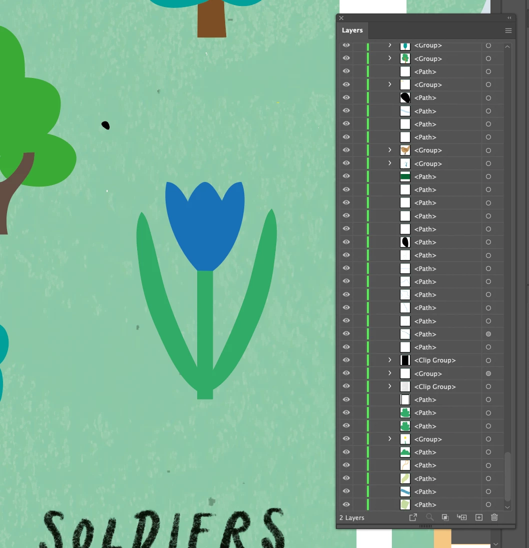

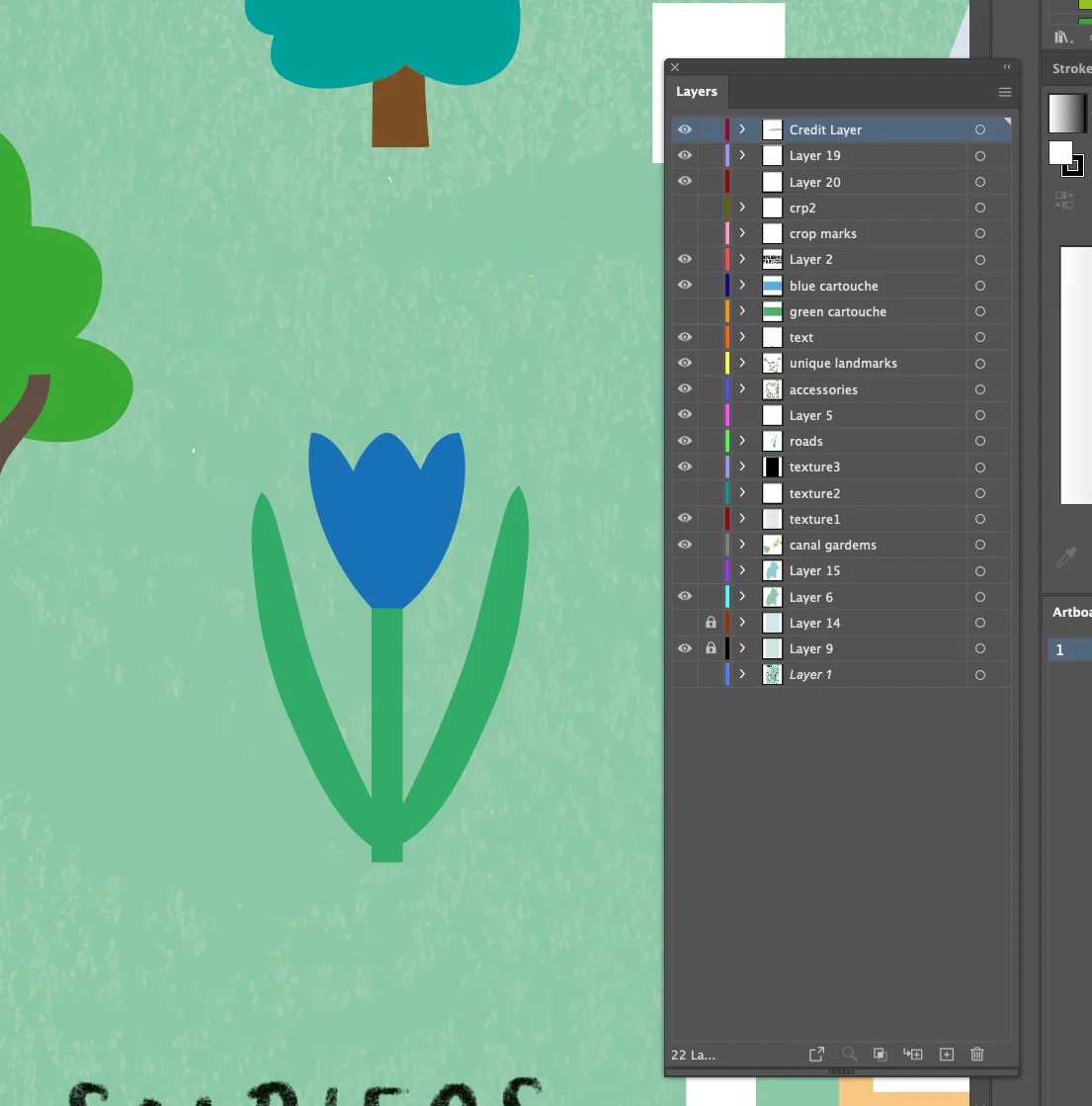

I had been supplied an illustrator file from an artist that had their work separated into layers. There were then some amends to the file and it was resupplied by the artist, however in this new file all the items seem to have been split into layers with unrecognisable layer names and the original layers had disappeared. The artist is using CS5 and i convert the file to latest version V25.4.1 (what ever that is in CS!).
Can anybody shed any light on this, please see attached screen grabs of how the layers came through on the original file and the new file.

October 18, 2021
Isn't that just an expanded view of one of the layers?
What do you need to do to the file - curious why you need to open the file if the modifications were already done?

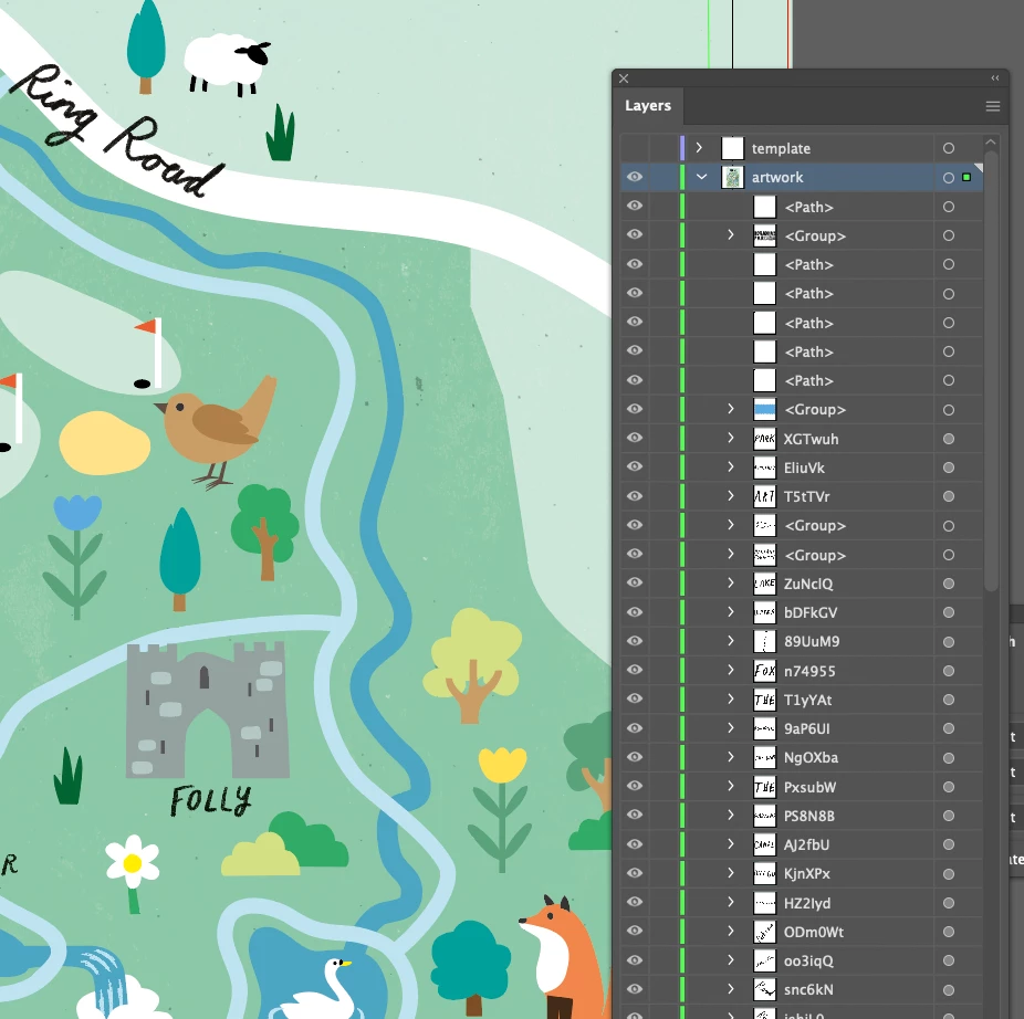

October 19, 2021
Hi Met1,
Thanks for your post!
No it seems to have lost the top level layers, please see attached.
At this stage I don't need to edit the file but I may do later and I am always curious of any issues and like to get to the bottom of them.
