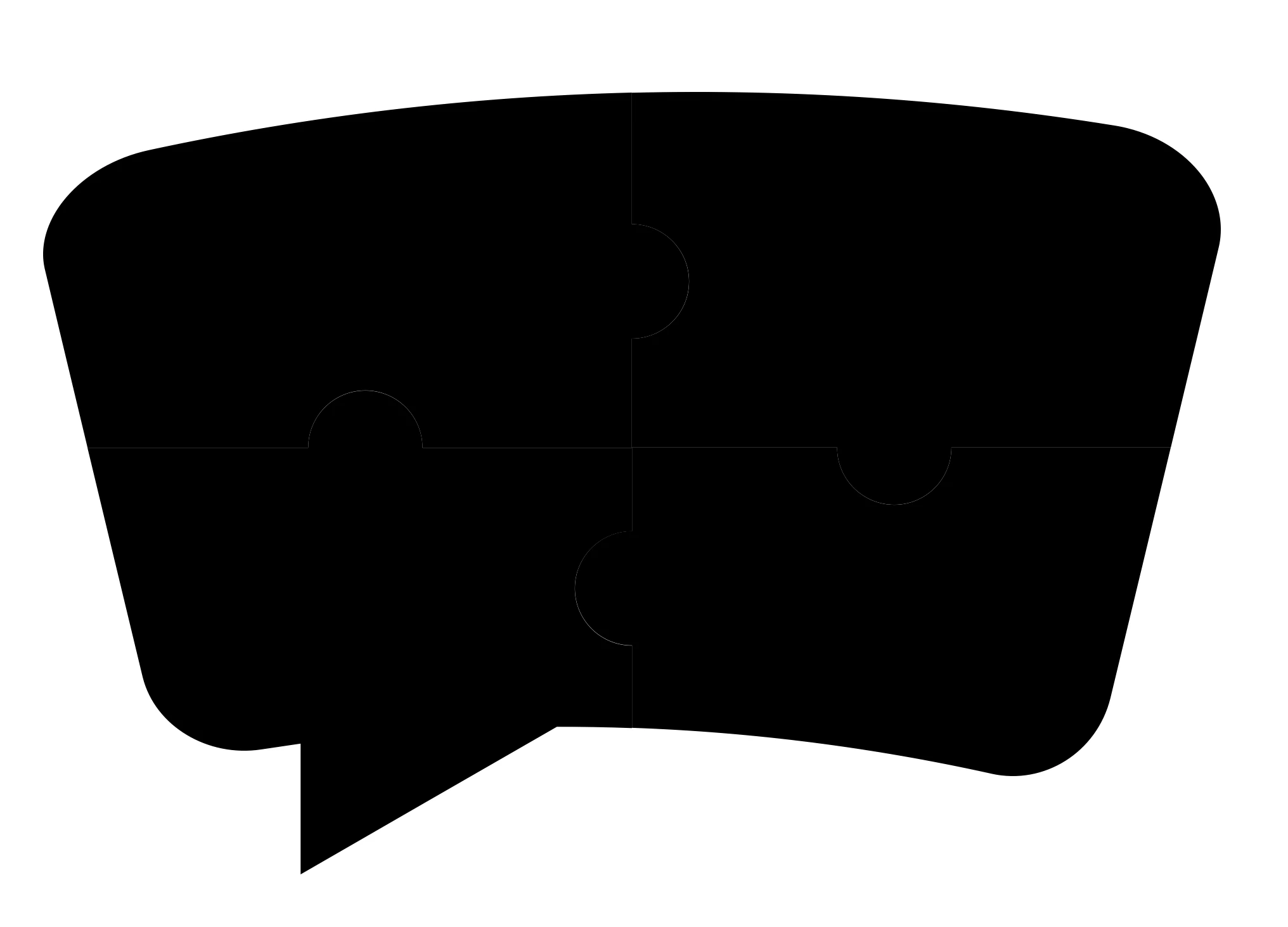

I can't seem to figure out why my SVGs are exporting with what looks like to be the width of a path as transparent space between shapes:
In Illustrator, I do not see these "white" lines/transparent space.  It is only when I export the SVG and open it in say PowerPoint or a browser.  It's like upon saving as an SVG, Adobe subtracts the width of the paths from shapes.  All 4 shapes/objects here should be touching each other.
P.S. I am on a mac so hopefully you can see the lines I am talking about in the above image.
Any help is appreciated.  Thank you!

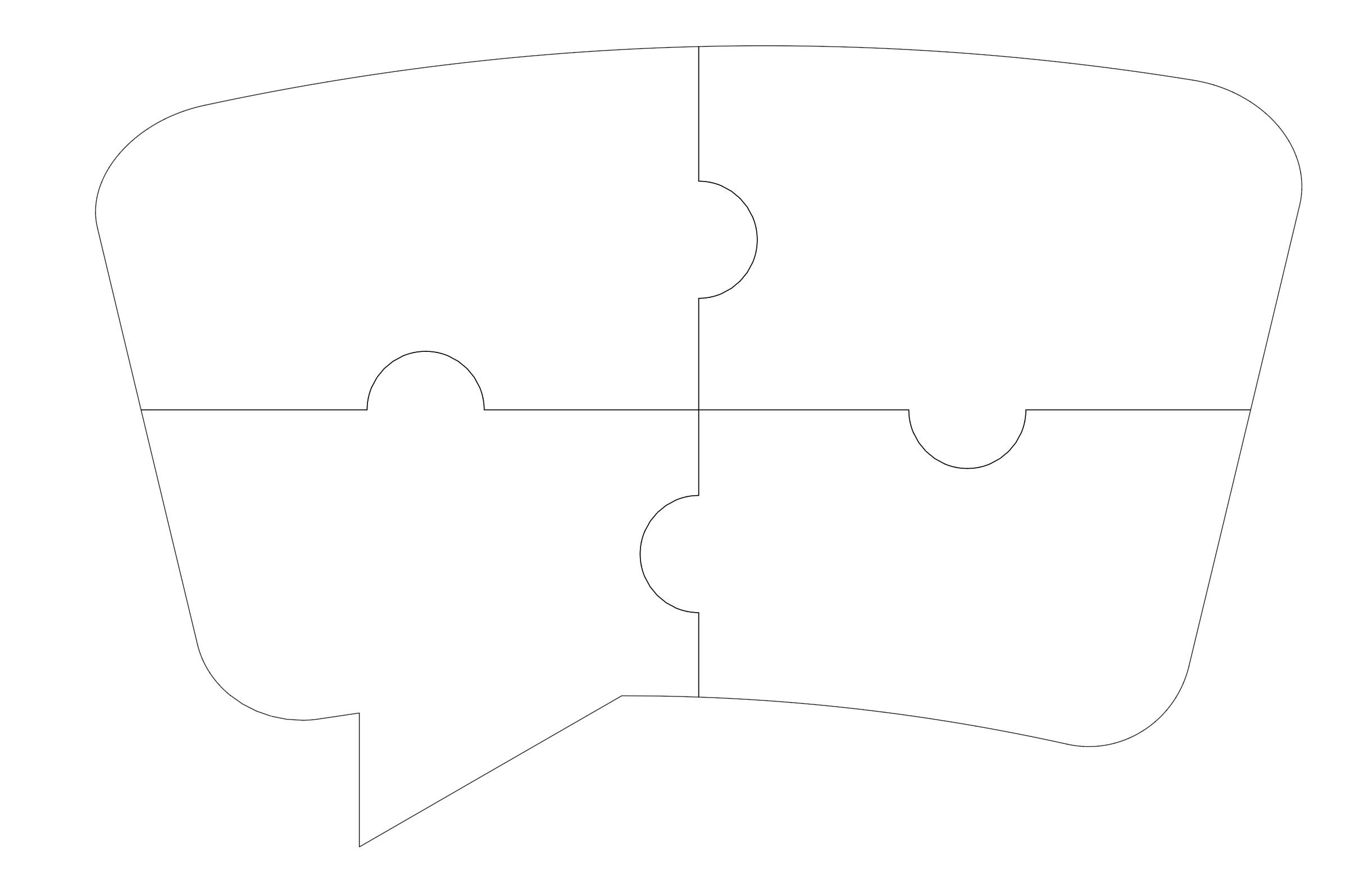

Can you please show the Outline view in Illustrator?
If there  are multiple paths that made this shape (using e.g. Live paint), then maybe expanding and uniting is an option?
July 14, 2022
Hi Monika,
Please see the below.  I am needing the SVG to be four separate shapes like it is now so each can be a separate color and editable in PowerPoint.
