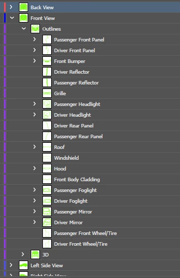

I have been trying to change the layers in my Illustrator file so that the changes reflect in my SVG after export, but then I open the SVG and all the layers are reverted back to their original names. I could change them successfully before, but it has since stopped working, and I am at a total loss as to why it won't update anymore. Any ideas?
NOTE: I am exporting under Save As > SVG because the SVG options under Export jumble the code in a difficult-to-read format for our developer.
This is my Ai file with the proper layer names:

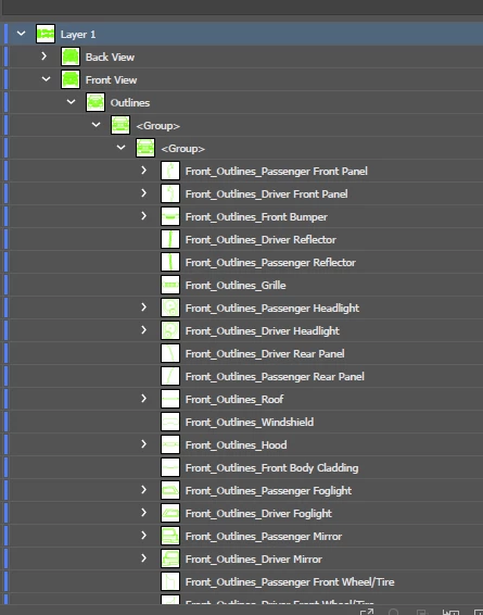

This is my exported SVG when opened in Illustrator:

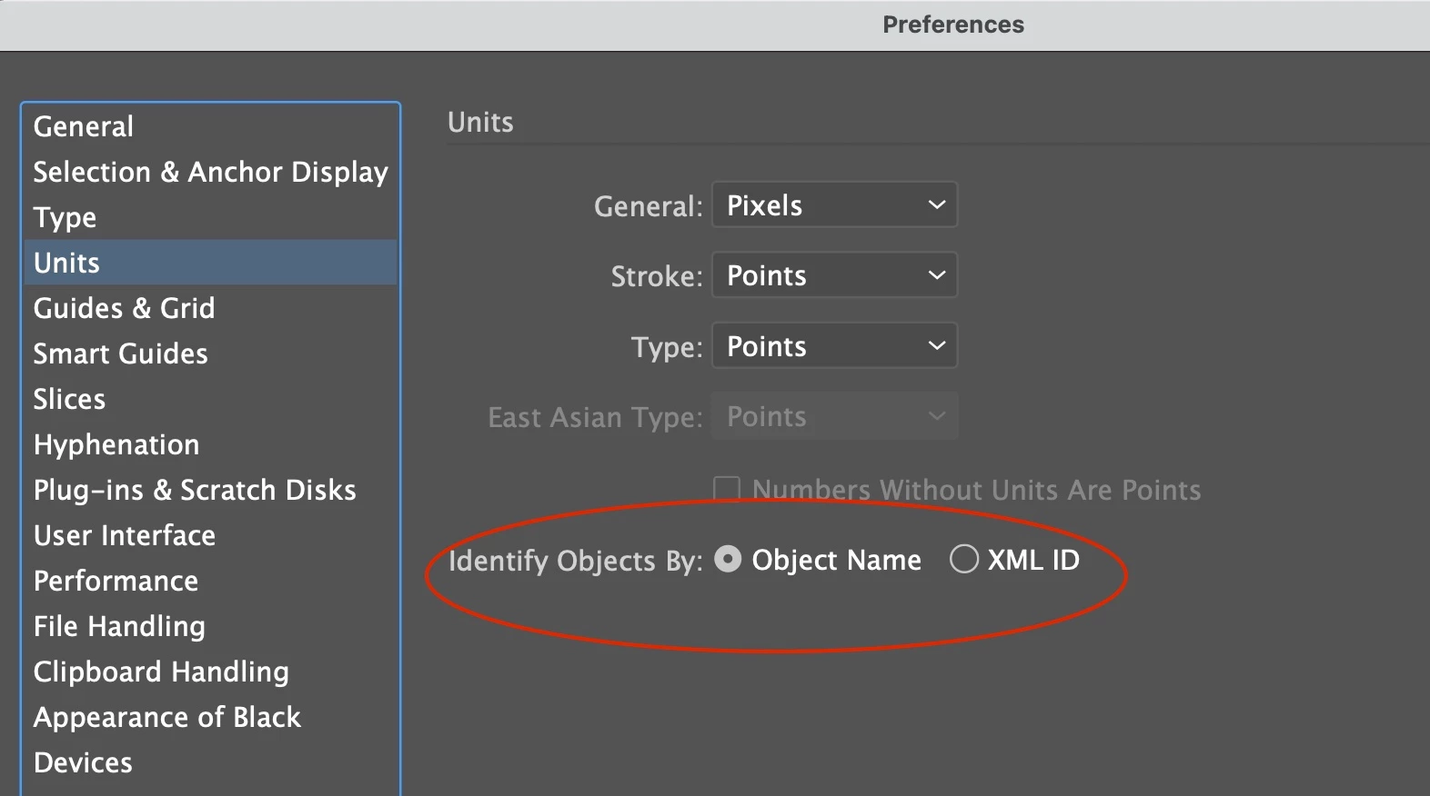

May 18, 2022 12:20 AM UTC
Could it possibly be your preference is checked for Identify Objects By: XML ID?

The SVG that I have exported has a bunch of extra numbers added to the Group ID in the code, and I can't figure out how to prevent that. My developer and I are thinking that it may be a buffer to prevent duplicate ID names, but we have tried different layer names in the Ai file and it is still adding the numbers.
There have been a few instances where there are no extra numbers added to the end, and I can't figure out what is different between the layers.
We are at a loss, so any help or insight would be appreciated!
EXAMPLE: This image illustrates the extra numbers added to the code, and a few instances when there are not any extra numbers added (under "Back View").
