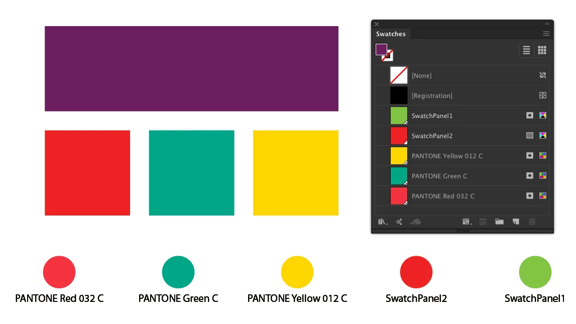

I've made a few modifications to the original and it works great except for the fact that it only looks for the swatches in the swatch panel. If it could be directed to used colours instead it would be perfect. Here's a screenshot. The three squares are vector art coloured with Pantone spots. The "SwatchPanel" spots should not be in the legend and there should be "circles" representing the CMYK in the purple rectangle.

since your last script works well with swatches in the swatches panel, you can select your objects manually and create a new Swatch Group with all selected colors used. Then you can modify your script to go through all swatches in the Swatch Group you just created instead of processing all swatches in the document.
About adding a second row. Currently you started with a fixed (x, y) position and as you went through your swatches you increased the x position by 70 points. Now instead of going east forever, you need to check each pass against a maximum x position where when reach it you reset your x position to what you had when you started. At that point you also update your y position to start a new row below your existing circles.
