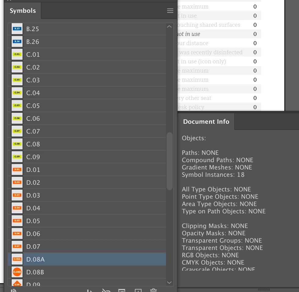

Hello!
Thank you for these!
I am gettign an error. is it becuase I named my symbols? They are all static graphic symbols
thank you!
