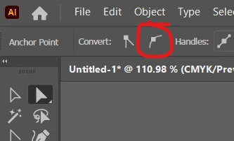

Mike_Gondek10189183
March 21, 2022
Select any point with the hollow arrow tool, then up above click on this, to convert anchor point to smooth.,
