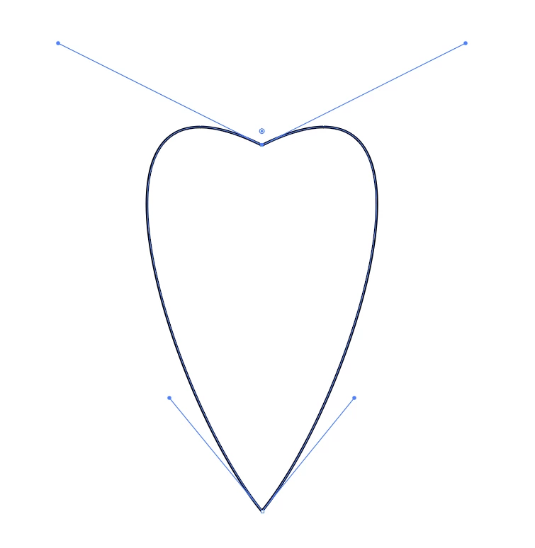

Mario Arizmendi
March 12, 2021
There are several ways to do symmetrical in illustrator, one of the easiest is with the help of the transform panel via appearance panel, see in my picture attached the basic parameters.
When finished editing your shape, just duplicate it and expand the appearance for final toches if needed, keep the original for other editions.
March 12, 2021
Hello Mario,
if I get your method right, I need to make all the adjustments before mirroring the part, is this correct?
Mario Arizmendi
March 12, 2021
No, you can do adjustments at any time.

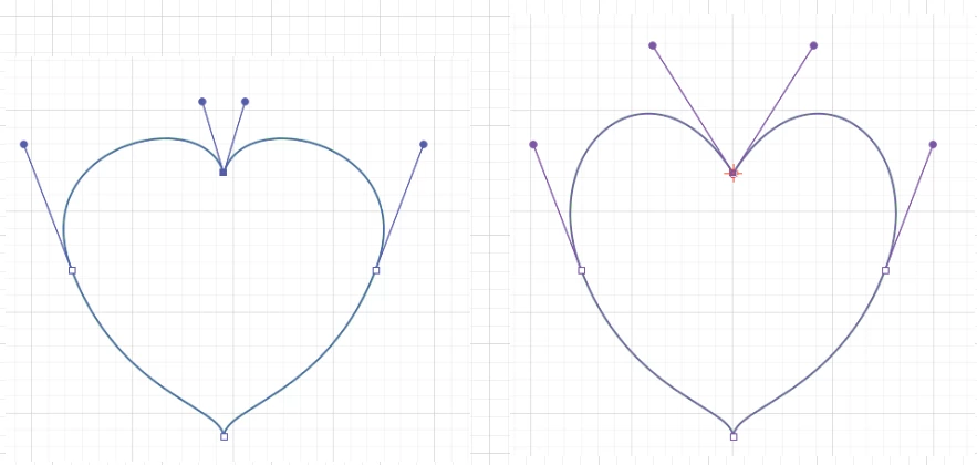

March 12, 2021
Hi Jacob,
that's what I thought of, too, but I don't seem able to select the two handle and move them together! 😞
Think of my heart made of just two points with curvature: I want to modify the curvature by moving handles, the anchor should stay where they are.
Can you help?
March 12, 2021
Unfortunately, there is no way to edit handles in a symmetric fashion once they are pulled out. Also you can not edit the handles of more than one anchor point. However, I would suggest adding another two anchor points in the paths to adjust the curvature.
