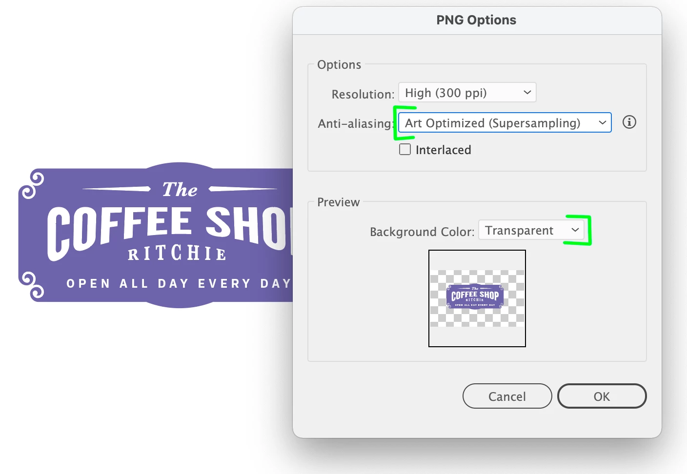

If your artwork is the right size (21 x 23), when you export to PNG at 300ppi for sure, your file will be correct. 300 is a bit overkill for a T-Shirt, but at least you are sending something crisp.
If you have your artwork in CMYK mode right now, you don't need to convert it to RGB now (that will haappen on the export based on your color settings anyway), HOWEVER if you are using a Pantone Swatch, you should change your document to RGB first, to get the most accurate swatch match before you export.
Check with your online vendor about what to do about whether a white ink is necessary under your colour logo (on non-white shirts)
