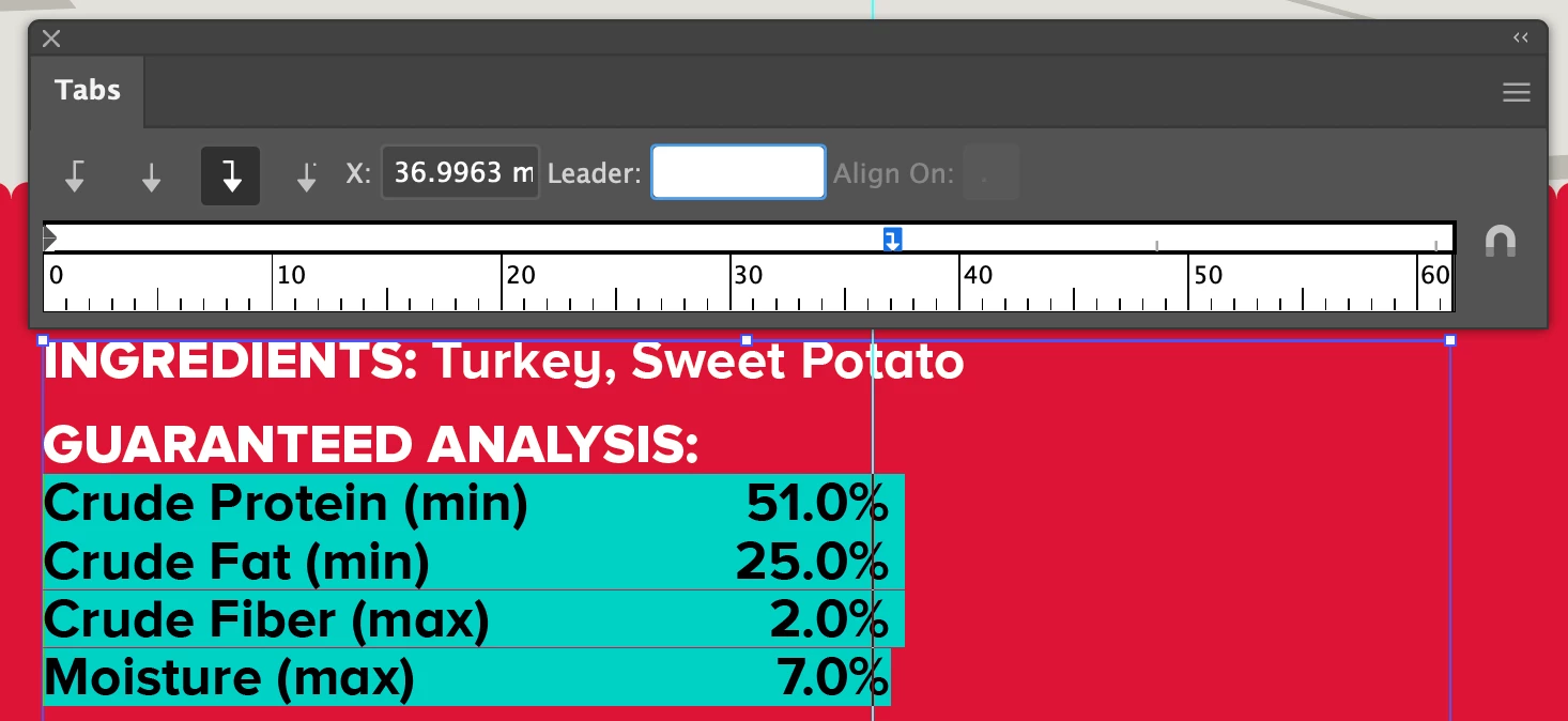

Here's a bug. Notice that without a leader character, the right side % symbols all line up properly.

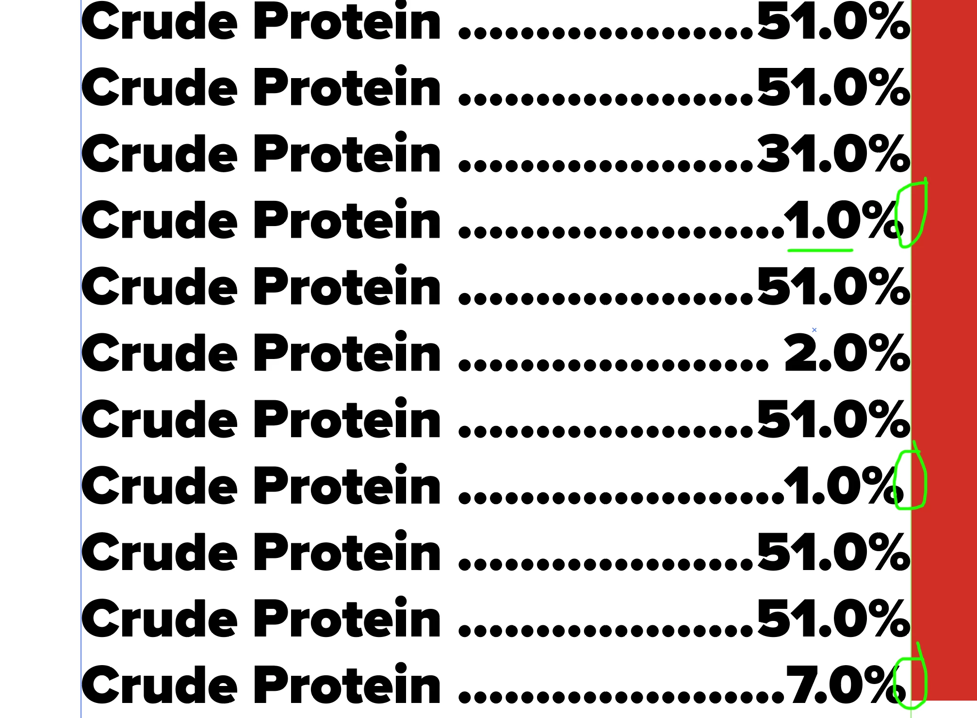

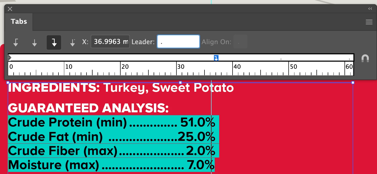

Now, with a '.' added as a leader character, the last % is knocked out of alignment.

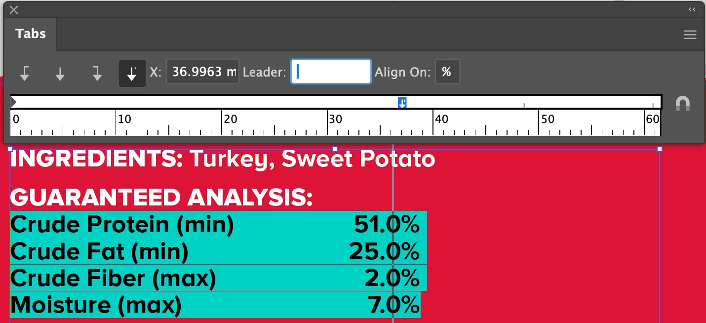

I've tried to use a decimal-justified tab...
...but the same exact misalignment occurs when I add a '.' as a leader character.

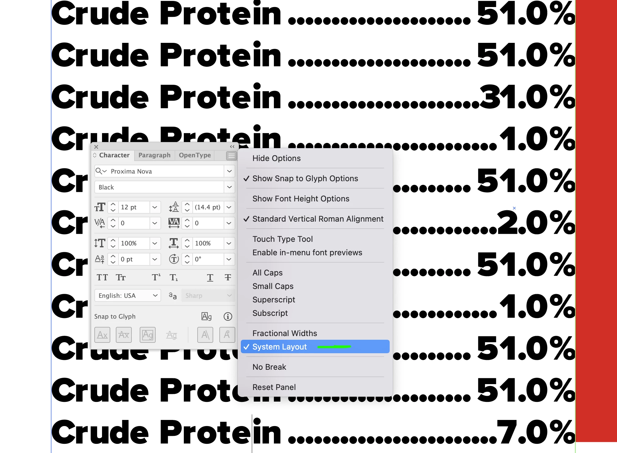

I did notice that if you changed the Type specs to toggle from Fractional Widths to System Layout, the effect disappears, so that might be your option for now.

I've also seen similar inconsistencies, Brad.
Moreover, toggling from Fractional Widths to System Layout and then back to Fractional Widths seems to surprisingly cure the issue as well. Can you confirm that?
Brad @ Roaring Mouse
May 7, 2024
Yes, but not consistently

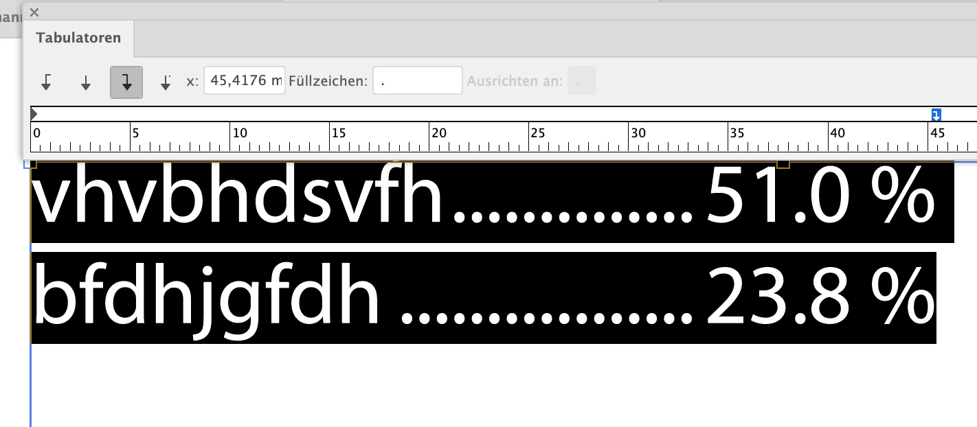

Monika Gause
May 7, 2024
Can't reproduce that. Can you share a demo file?

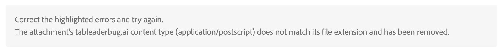

I wish I could, but this site will not allow a simple Illustrator file to be uploaded. I guess we found another bug.
I've been able to correct the alignment with kerning, but for whatever reason, adding a leading period character throws off the alignment of the last line every single time on my machine.
